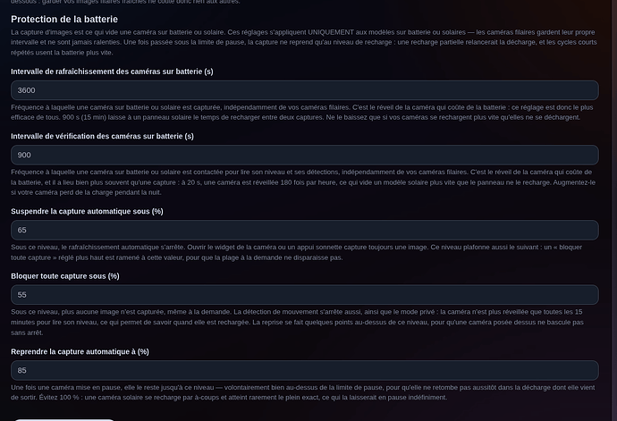

Hello Will_71, I’m back and still having issues with my cameras.
1 - The battery-powered solar Tapo C660 cameras have been recognized since the integration, but there’s no stream. We know why.
2 - On the other hand, I also have an indoor camera connected to 220V, a Tapo C230, which has been well recognized since the integration, with a camera account configured, third-party compatibility enabled, and yet during discovery, only the camera (image) functionality is reported, and despite that, no stream. The error message is TAPO_CAMERA_IP_UNKNOWN. I think I’ve tried everything, even specifying the IP…
3 - The Tapo D235 doorbell has not been discovered since the integration. I don’t know what to do???
Nothing dramatic in itself, but it’s frustrating. If anyone has succeeded with this type of equipment, I’m interested.
Thanks in advance

Personally, I have 3 TAPO cameras, one of which is battery-powered, and all three work, so there’s no reason for the battery-powered one not to work for you.

Here are some logs
[2026-10-11T13:30:18.369Z] [WARN] Refreshing the image of "Tapo_C230_Living Room" failed: TAPO_CAMERA_IP_UNKNOWN
[2026-10-11T13:30:58.759Z] [INFO] onConfigUpdated -> reloading the configuration
[2026-10-11T13:30:59.015Z] [INFO] Connected to the TP-Link cloud
[2026-10-11T13:30:59.187Z] [INFO] 3 Tapo camera(s) found in the cloud
[2026-10-11T13:31:01.647Z] [INFO] 3 Tapo camera(s) found in the cloud
[2026-10-11T13:31:01.659Z] [WARN] The network scan failed: Too Many Requests
[2026-10-11T13:31:01.699Z] [WARN] "Tapo_C660_Back" (C660) has no known local address. Add it under "Camera addresses" as "Tapo_C660_Back|192.168.x.y".
[2026-10-11T13:31:01.699Z] [WARN] "Tapo_C230_Living Room" (C230) has no known local address. Add it under "Camera addresses" as "Tapo_C230_Living Room|192.168.x.y".
[2026-10-11T13:31:01.699Z] [WARN] "Tapo_C660_Front" (C660) has no known local address. Add it under "Camera addresses" as "Tapo_C660_Front|192.168.x.y".
[2026-10-11T13:31:04.250Z] [WARN] "Tapo_C660_Back" (C660) has no known local address. Add it under "Camera addresses" as "Tapo_C660_Back|192.168.x.y".
[2026-10-11T13:31:04.250Z] [WARN] "Tapo_C230_Living Room" (C230) has no known local address. Add it under "Camera addresses" as "Tapo_C230_Living Room|192.168.x.y".
[2026-10-11T13:31:04.250Z] [WARN] "Tapo_C660_Front" (C660) has no known local address. Add it under "Camera addresses" as "Tapo_C660_Front|192.168.x.y".
[2026-10-11T13:31:04.287Z] [WARN] The resume level is set to 85%: a solar camera rarely reads that high, and one that dips below 65% may stay paused indefinitely.
[2026-10-11T13:31:04.288Z] [INFO] Watching the Tapo events every 20s
[2026-10-11T13:31:04.288Z] [INFO] Refreshing the camera images every 60s (battery cameras: every 3600s)
[2026-10-11T13:32:04.340Z] [WARN] Refreshing the image of "Tapo_C230_Living Room" failed: TAPO_CAMERA_IP_UNKNOWN
[2026-10-11T13:32:38.743Z] [INFO] 3 Tapo camera(s) found in the cloud
[2026-10-11T13:32:43.797Z] [WARN] "Tapo_C660_Back" (C660) has no known local address. Add it under "Camera addresses" as "Tapo_C660_Back|192.168.x.y".
[2026-10-11T13:32:43.798Z] [WARN] "Tapo_C230_Living Room" (C230) has no known local address. Add it under "Camera addresses" as "Tapo_C230_Living Room|192.168.x.y".
[2026-10-11T13:32:43.798Z] [WARN] "Tapo_C660_Front" (C660) has no known local address. Add it under "Camera addresses" as "Tapo_C660_Front|192.168.x.y".
[2026-10-11T13:32:43.813Z] [WARN] The test capture of "Tapo_C230_Living Room" failed: TAPO_CAMERA_IP_UNKNOWN
[2026-10-11T13:33:02.679Z] [INFO] onConfigUpdated -> reloading the configuration
[2026-10-11T13:33:02.885Z] [INFO] Connected to the TP-Link cloud
[2026-10-11T13:33:03.060Z] [INFO] 3 Tapo camera(s) found in the cloud
[2026-10-11T13:33:04.350Z] [WARN] Refreshing the image of "Tapo_C230_Living Room" failed: TAPO_CAMERA_IP_UNKNOWN
[2026-10-11T13:33:08.125Z] [WARN] "Tapo_C660_Back" (C660) has no known local address. Add it under "Camera addresses" as "Tapo_C660_Back|192.168.x.y".
[2026-10-11T13:33:08.125Z] [WARN] "Tapo_C230_Living Room" (C230) has no known local address. Add it under "Camera addresses" as "Tapo_C230_Living Room|192.168.x.y".
[2026-10-11T13:33:08.125Z] [WARN] "Tapo_C660_Front" (C660) has no known local address. Add it under "Camera addresses" as "Tapo_C660_Front|192.168.x.y".
[2026-10-11T13:33:08.137Z] [WARN] The resume level is set to 85%: a solar camera rarely reads that high, and one that dips below 65% may stay paused indefinitely.
[2026-10-11T13:33:08.137Z] [INFO] Watching the Tapo events every 20s
[2026-10-11T13:33:08.138Z] [INFO] Refreshing the camera images every 60s (battery cameras: every 3600s)
[2026-10-11T13:33:11.911Z] [WARN] Refreshing the image of "Tapo_C230_Living Room" failed: TAPO_CAMERA_IP_UNKNOWN
[2026-10-11T13:33:11.911Z] [WARN] Refreshing the image of "Tapo_C660_Back" failed: TAPO_CAMERA_IP_UNKNOWN
[2026-10-11T13:33:11.911Z] [WARN] Refreshing the image of "Tapo_C660_Front" failed: TAPO_CAMERA_IP_UNKNOWN
