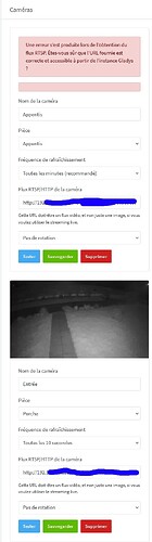

I have 2 identical NETATMO cameras integrated into Gladys for a very long time.
An error is shown in the « Camera » integration for one of the devices even though I didn’t touch anything and the other device has no problem.
Image of the Netatmo web interface:

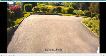

  • Have you tested the stream in VLC to make sure it works properly? (Documentation → Caméra | Gladys Assistant )

  • The VLC video stream is OK (Appentis)
