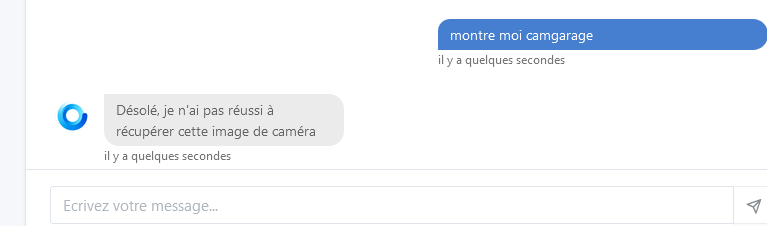

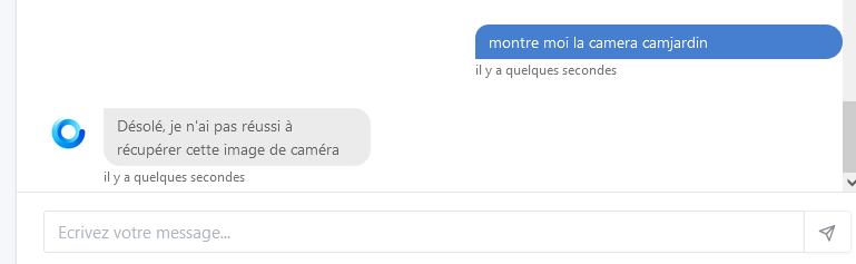

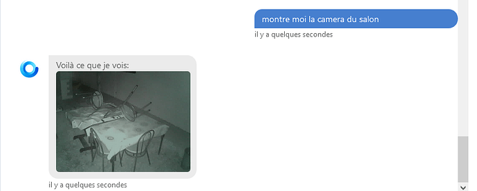

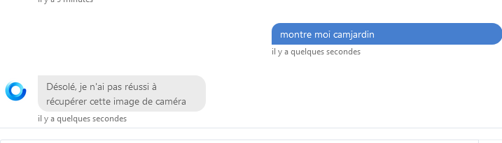

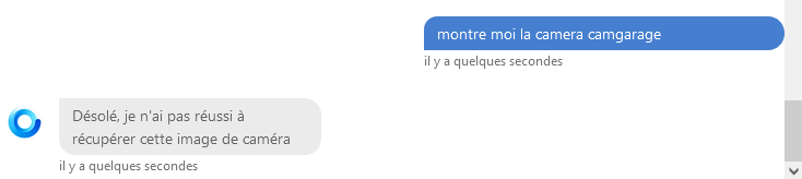

It doesn’t work for me:
I have, for the test, 2 cameras, one is called camgarage and the other camjardin. I put them in the same room: the living room.
1st request :
2nd request :
or
3rd request:
or
Conclusion
when I call the room’s cameras, only one appears
when I call the cameras by their names, Gladys doesn’t retrieve them.
Is there a specific phrase to use?
Thanks for taking care of this dev :wink:
