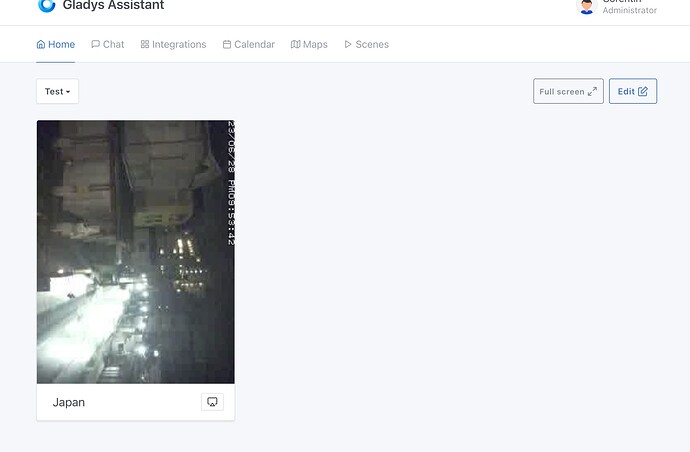

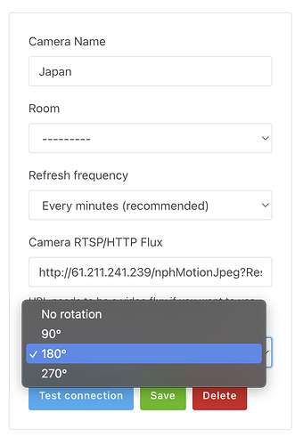

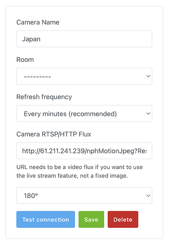

Add possibility to rotate camera at 90°, 180° and 270°
<img width="1040" alt="Screenshot 2023-06-28 at 14 54 01" src="https://github.com/GladysAssistant/Gladys/assets/11317212/7260c569-4cff-4693-8b2a-8ab33ada49dd">
<img width="383" alt="Screenshot 2023-06-28 at 14 52 04" src="https://github.com/GladysAssistant/Gladys/assets/11317212/167e88be-71eb-4d17-ac85-7366408ae22b">
<img width="382" alt="Screenshot 2023-06-28 at 14 51 57" src="https://github.com/GladysAssistant/Gladys/assets/11317212/0e6714d1-19bd-4002-a918-7bc91a7999fa">
