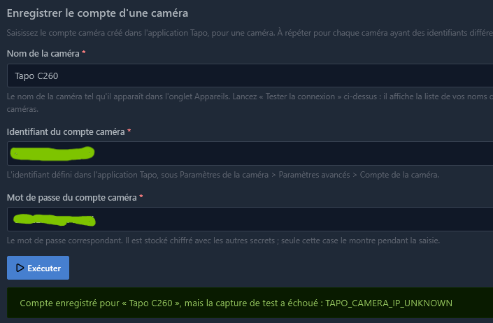

I have a Tapo C260 camera that works fine and I can retrieve the image with the internal camera integration
But with the Tapo integration I see nothing:

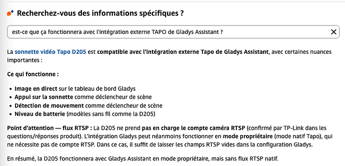

I’m looking at a Tapo doorbell and I’m pleasantly surprised by Rufus’ (Amazon) response :face_with_raised_eyebrow:
@Chris75 For local control, you need to enter the IP address

I’m considering a Reolink with PoE, 2.5 times more expensive, but I can’t figure out if it’s cloud and/or local.
ok, the image was captured correctly:
But it doesn’t display
Screenshot 2026-08-11 221241
You need to add a camera widget

By the way, I found it, finally Claude, to have the video stream for the battery cameras that have RTSP blocked, but in the integration I did not allow the live stream. Only snapshots
Now I don’t understand: the « camera Â» widget already worked very well with the internal « camera Â» integration where I had put the RTSP stream. So what does the external tapo integration add?
Nothing more today, well almost, there is a function to retrieve images from a battery-powered camera that doesn’t have RTSP, for example.
Afterwards, it allows you to fill in the RTSP address for those who don’t know how and only know the IP.
