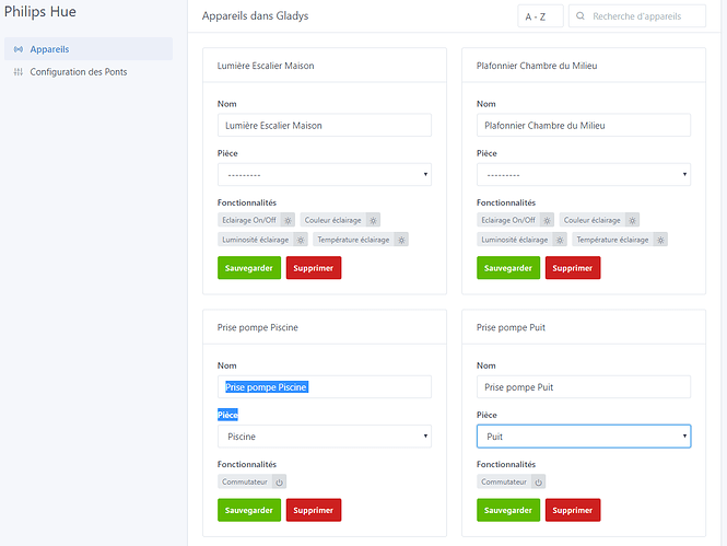

@Terdious I’m looking to implement the outlets, I’ll need you to test as I don’t have any
Yes of course @VonOx, no problem, let me know when you need
Hi @VonOx,
I just implemented it in dev as follows:
Code
case 'LOM002': // Hue Smart Plug On/Off in:
It works perfectly:
Philips Hue Device View and Dashboard
@VonOx, do you approve? Should we do a test first? Because I don’t know how to do that…^^ But if you teach me, as I can’t follow the documentation, I can take care of it.
