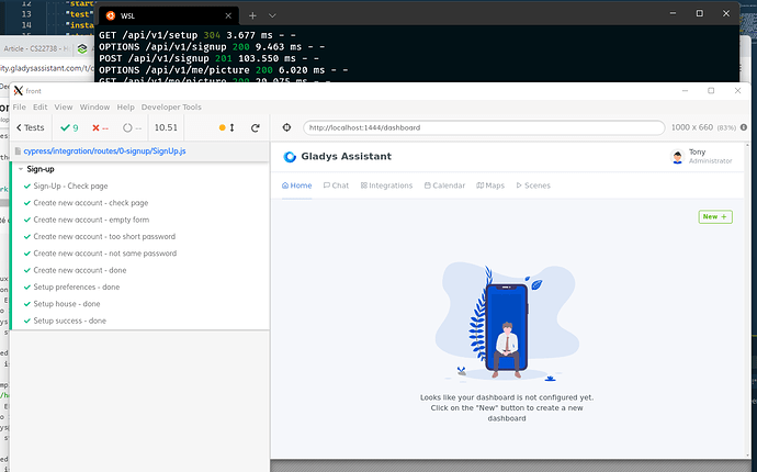

Hi @AlexTrovato :wave:
I tested the Cypress branch you developed today and it works well :slight_smile:

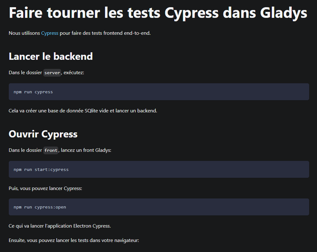

  • I followed the documentation:
  • I then launched the server command:

  • I then launched the front command:

  • I then tried to follow the link you provide in your slides:
But nothing works :smiling_face_with_tear: :smiling_face_with_tear:
Thanks in advance !!
I followed the WSL 2 procedure and it’s OK on my side

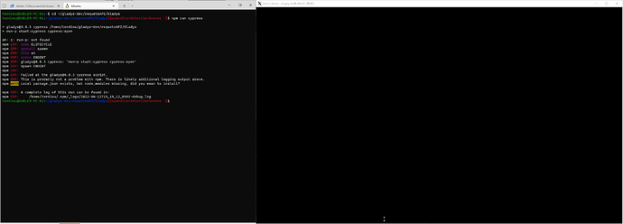

Have you launched xlaunch on Windows before?
Before cypress:open yes.
After that, I tried to restart the server and front end as well, but nothing. I have no client on Xlaunch. Any specific ports to open?
The only and unique root command npm run cypress :slight_smile:
Oops lol I followed the doc:
Well, however, it works even less with the only one ^^

Did you run npm install at the root of Gladys first?
Install nodejs v14 too :grin:
Sure :sweat_smile:, :smiling_face_with_tear:
Better to ask ^^
Oh yes indeed that may not be the case… I’ll check it out!!
According to the log, you’re on 12
Indeed ^^
Well, it’s done, so it adds things, at least it really tries to launch ^^
But it crashes ^^ - I’ll check that this evening when I get home ^^:

    at Object.Module._extensions..node (internal/modules/cjs/loader.js:1144:18)
    at Module.load (internal/modules/cjs/loader.js:950:32)
    at Function.Module._load (internal/modules/cjs/loader.js:790:12)
    at Module.require (internal/modules/cjs/loader.js:974:19)
    at require (internal/modules/cjs/helpers.js:101:18)
    at Object.<anonymous> (/home/terdieu/gladys-dev/requeteAPI/Gladys/server/node_modules/node-webcrypto-ossl/buildjs/native.js:3:16)
    at Module._compile (internal/modules/cjs/loader.js:1085:14)
    at Object.Module._extensions..js (internal/modules/cjs/loader.js:1114:10)
    at Object.<anonymous> (/home/terdieu/gladys-dev/requeteAPI/Gladys/server/node_modules/node-webcrypto-ossl/buildjs/key_storage.js:8:16)
    at Module.load (internal/modules/cjs/loader.js:950:32) {
  code: 'ERR_DLOPEN_FAILED'
npm ERR! code ELIFECYCLE
  ⠙  Verifying Cypress can run /home/terdieu/.cache/Cypress/6.9.1/Cypress
npm ERR! gladys-server@ cypress:start: `cross-env SQLITE_FILE_PATH=./gladys-cypress.db node index.js`
npm ERR! Exit status 1
npm ERR!
npm ERR! Failed at the gladys-server@ cypress:start script.
npm ERR! This is probably not a problem with npm. There is likely additional logging output above.
npm ERR! A complete log of this run can be found in:
npm ERR!     /home/terdieu/.npm/_logs/2022-04-13T04_06_38_053Z-debug.log
npm ERR! errno 1
npm ERR! gladys-server@ cypress: `npm run cypress:clean && npm run cypress:start`
npm ERR!
npm ERR! Failed at the gladys-server@ cypress script.
npm ERR!     /home/terdieu/.npm/_logs/2022-04-13T04_06_38_092Z-debug.log
npm ERR! errno 1
npm ERR! gladys@4.8.3 start-server:cypress: `cd server && npm run cypress`
npm ERR!
npm ERR! Failed at the gladys@4.8.3 start-server:cypress script.
npm ERR!     /home/terdieu/.npm/_logs/2022-04-13T04_06_38_114Z-debug.log
  ⠹  Verifying Cypress can run /home/terdieu/.cache/Cypress/6.9.1/Cypress
npm ERR! errno 1
npm ERR! gladys@4.8.3 start:cypress: `run-p start-server:cypress start-front:cypress`
npm ERR!
npm ERR! Failed at the gladys@4.8.3 start:cypress script.
npm ERR!     /home/terdieu/.npm/_logs/2022-04-13T04_06_38_161Z-debug.log
ERROR: "start:cypress" exited with 1.
npm ERR! errno 1
npm ERR! gladys@4.8.3 cypress: `run-p start:cypress cypress:open`
npm ERR!
npm ERR! Failed at the gladys@4.8.3 cypress script.
npm ERR!     /home/terdieu/.npm/_logs/2022-04-13T04_06_38_202Z-debug.log
Didn’t you mean to put node 16 instead of 14? :smiley:
Mmmmh not even ^^
It’s crazy when it doesn’t work ^^ There must be a reason but …
I’m going to sift through the logs to see if there’s a clue …
However, you need to run npm rebuild if you changed the Node.js version (it’s written in the previous logs) because the packages were installed under Node 12.
