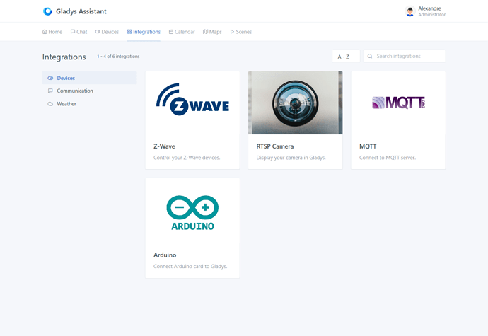

After a hard day’s work, I finally managed to install my server, so I was able to check my first contributions:
The development of the Arduino service begins!
I have a lot of ideas regarding the configuration and interaction pages with the associated devices. I have a week off, so I will take advantage of it to make as much progress as possible. I will give you an update as soon as I have a functional start: wink:
