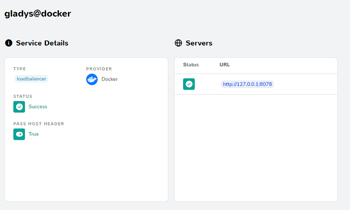

This is my Traefik label that links the service to port 8078
In my Traefik Dashboard, I can see my Host:
Eoras
November 17, 2023, 9:20am
9
That points to a service that is indeed on port 8078

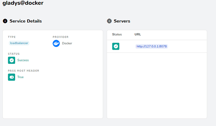

So I removed the traefik network, switched back to host mode, and modified my label with :
- \"traefik.http.services.gladys.loadbalancer.server.url=http://192.168.86.20:8078\"
On my traefik I have the server URL: http://127.0.0.1:8078 — it still hasn’t been updated and I still have my Bad Gateway
In fact, this option traefik.http.services.service01.loadbalancer.server.url exists in the configuration via toml file , but not in the configuration via docker label
