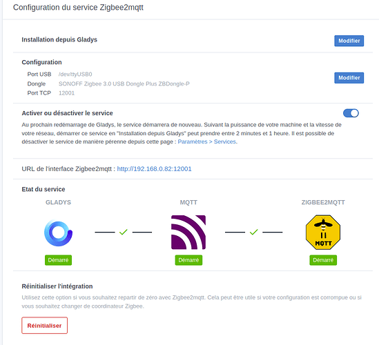

Hello, I have two ZIGBEE thermometers that suddenly stopped sending information to GLADYS. I removed them from the zigbee2MQTT configuration but I can’t reinstall them…
Also, my service seems OK

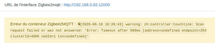

I reset the integration but without success. However, since then I have this message:
Thanks in advance

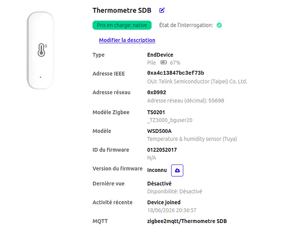

Using a backup, I was able to restore a state where my sensors are paired, but no data is coming through..
However, the sensors are properly detected
But in Gladys, no information is coming through.. strange?

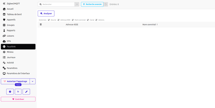

And regarding the Zigbee2mqtt integration in Gladys, did you add the devices to Gladys? Don’t you have anything in the « Zigbee Discovery » tab?
no, in discovery I don’t see anything… :confused:

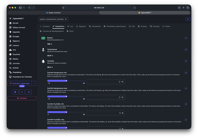

Are the data not being sent to Gladys, or are they not being sent to Zigbee2MQTT in the first place?
To check, log in to Zigbee2MQTT, click on your sensor in the device list, then open the “Exposures” tab:
Note the displayed value (or take a screenshot), then come back to check about an hour later.
Unless the temperature is extremely stable in your home, you should notice a change.
  • If the value has not changed, the problem is probably between the sensor and Zigbee2MQTT.
  • If the value has changed in Zigbee2MQTT but not in Gladys, then the problem is probably between Zigbee2MQTT and Gladys. :slightly_smiling_face:
This will already allow us to precisely identify where the communication chain is breaking.
If you don’t want to wait an hour, you can put your sensor in your hand, it will heat up faster :ok_hand:

Well, nothing changes on the « exhibition » page of my sensors…

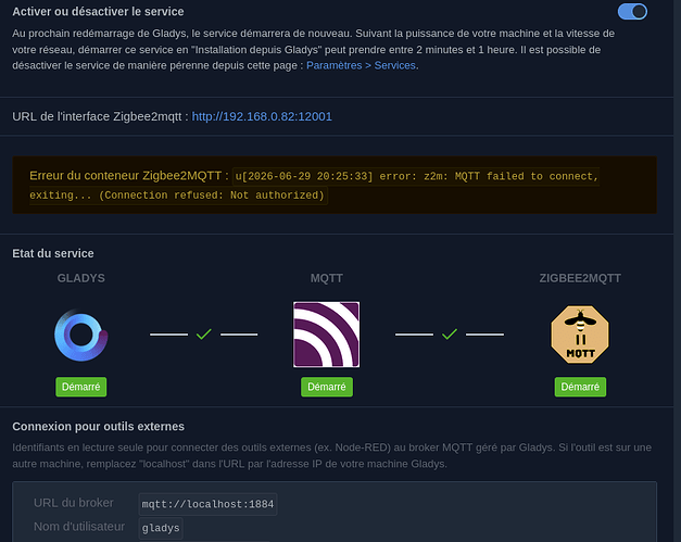

I’m seeing this now.. But the sensor data is coming back!!
I don’t understand anything anymore
The error message might be a relic. If Zigbee2mqtt is available and everything is working, you can ignore it :slight_smile:
