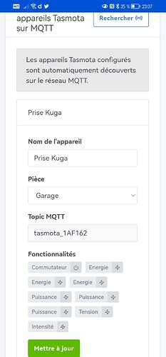

First test, new installation.
The socket is properly detected and the units are correct

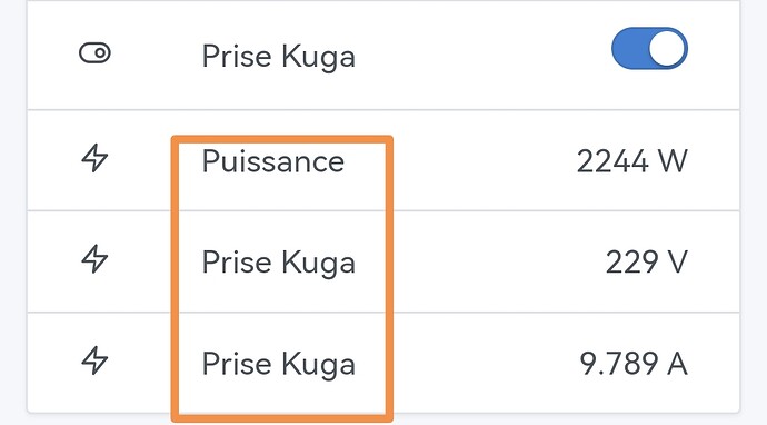

However, according to the ‹ devices/features › naming logic, shouldn’t we have, as currently:
Not that it was better before — not at all — but does this cause any problem or risk of conflict? I know there have been recent changes regarding this…

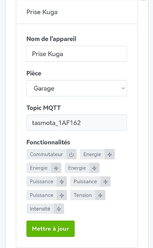

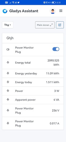

Update appears immediately in the Tasmota integration, MQTT discovery

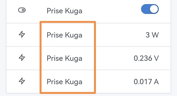

On the dashboard:

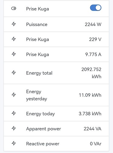

Then once we add the new values:

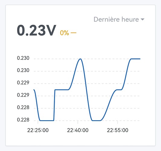

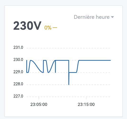

On the graph, it looks like this:
Previously, it looked like this:
However, maybe I need to wait for aggregation, but here there is no data for three months…

I think what’s happening here is that because you have a device that has the same feature multiple times, the display switches to « complex device display » mode.
Your Kuga plug has 3 different functionalities (W, V and A), so we can differentiate the three and therefore the device name is displayed (and not the feature)

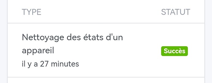

« Cleaning a device’s states » is a task that is triggered when a feature is removed.
In the case of this PR, I couldn’t tell you :slight_smile:

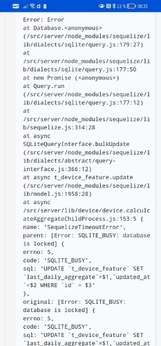

And an error in the aggregation:
But I’m on the RPi 2 for testing and it’s struggling so much that it could be coming from there…
I’m restarting the DB transfer…
Ah yes, indeed that could well be the cause. I’m on the PC myself!!
@pierre-gilles ? Any solution for this scenario? Limit the data packets to be processed during the migration?
Oh, this is an exceptional case where I’m transferring the 4 GB database from an RPi4 installation to an RPi2. And given the size of the database, I’m forced to leave it on the USB stick, so it’s not great. It takes about fifteen minutes for Gladys to start under these conditions :innocent:.
