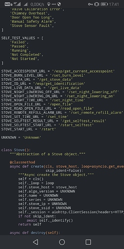

I found this work on Github in Python for Home Assistant.
Would a kind developer passing by feel like looking at this with me to get it into Gladys?
I know, it’s exotic hardware, customers for this stove are rare and even more so those under Gladys… :stuck_out_tongue:

The only information I have comes from the Home Assistant GitHub repository.
I tried contacting the manufacturer but no news…
You should check these URLs to see how authentication is handled.
https://github.com/mvn23/hwam_stove/blob/master/pystove/pystove.py
0! I think you just need to be on the local network…
Return from http://192.168.1.179/get_stove_data

So for a seasoned small developer, it shouldn’t be too violent to integrate into Gladys, at least for data retrieval… :stuck_out_tongue:
Oh, that shouldn’t be too complicated. :blush:
I’ve formatted the JSON to make it more readable.
Will you be able to post the results of all the get* URLs?

In theory, if you want to control the heating level of your stove, it seems that the route « /set_burn_level » is your friend.
In Postman, you should be able to make a POST request to this URL by specifying in the body:
  "level": 1
The question is, what range of « level » is available to you.
I imagine that by manually setting your stove to the MIN and MAX values, and querying « /get_stove_data » before and after the changes, you should be able to deduce the threshold values from the response to the key « burn_level ».
This should allow you to adjust your stove to « more or less strong ».
My 2 cents

The get commands work, but the post set_burn_level command does not work. When the request is executed, it gives an OK response, but the result is that for different values tested, I always get the result level = 0
Is there a way to find the right command or parameter? I am ready to help, even though I am not an expert.
regards
and here I found the correct formatting:
{« level »:1}
and set header: accept application/json
