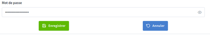

Hi @pierre-gilles,

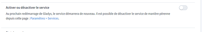

One small thing about the password: I can’t click the eye to reveal/check the password
I’m blocked because I can’t enable the service
After restarting it’s still the same.

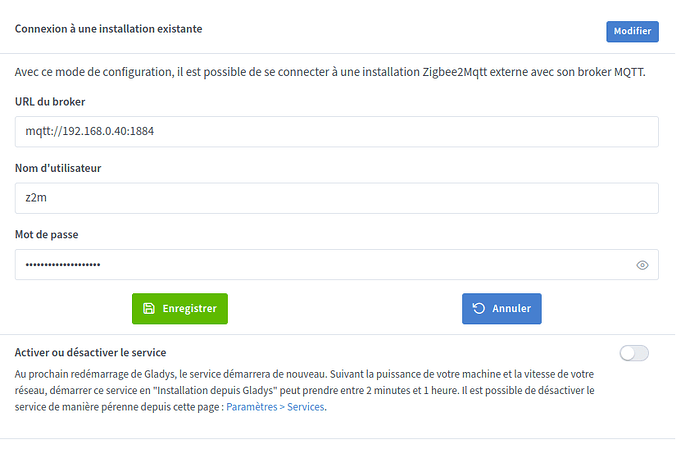

Which username and password are being used?
Because I can set the z2m parameters in the integration but it seems like it’s trying to connect with the MQTT parameters!
This instance is a Gladys test instance that I have on my PC which already had an MQTT broker with zigbee2mqtt configured and working.
For the test I removed my key and in the configuration I changed the settings to connect to an existing installation

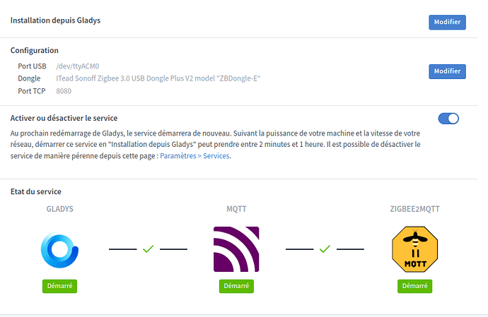

  • Fresh install of a Zigbee2mqtt configuration with the container launched by Gladys :white_check_mark:

So if I try an installation via Gladys no problem, everything works. I can disable and re-enable without any issue.

Ok, to get more info to reproduce it, you’re trying to connect to a remote broker, and you manually enter a username and a password, right?
Did you type the username « z2m » yourself?
Are you sure that from the container you can access that MQTT broker?
Yes, it was indeed me who typed them.
Yes, I can connect with MQTT Explorer
To be sure, I also launched a network search from Gladys and I can find the machine that hosts this broker

Thank you for your feedback @_Will_71, the port in your screenshot is 1884, is that the correct port?
