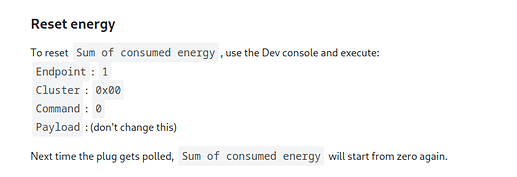

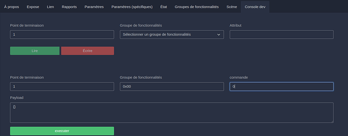

In zigbee2mqtt, it is possible from the Dev console to execute a command to reset the plug’s consumption.
Here is the info on the zigbee2mqtt website
I did a test and it works, you just need to enter the specified data and execute it and the consumption goes back to zero!
