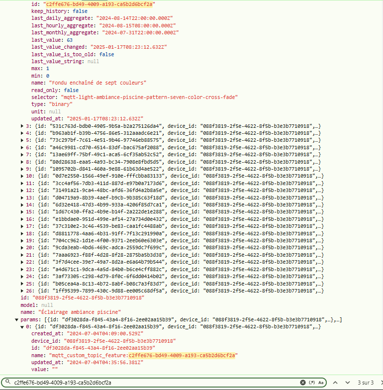

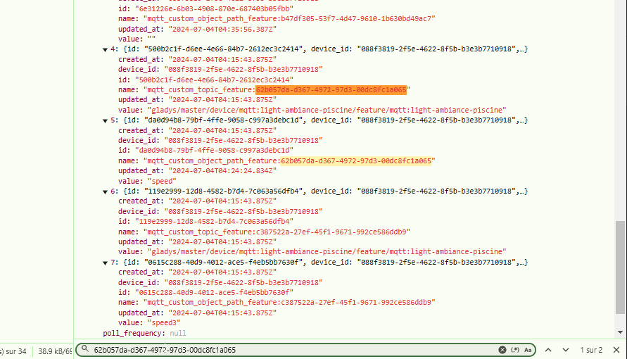

Hi @pierre-gilles,
Following your reply, I pushed the logs a bit further. It’s clearly an error in the fields… So the issue will probably be how to alert about this but not only that. Let me explain: in the custom file I logged:
  • device.param :
device.params [
    device_id: '088f3819-2f5e-4622-8f5b-b3e3b7710918',
    value: '',
    created_at: 2024-07-04T04:09:00.529Z,
    updated_at: 2024-07-04T04:35:56.381Z
    value: '',
    updated_at: 2024-07-04T04:35:56.386Z
    value: '',
    updated_at: 2024-07-04T04:35:56.385Z
    value: '',
    updated_at: 2024-07-04T04:35:56.387Z
    value: 'gladys/master/device/mqtt:light-ambiance-piscine/feature/mqtt:light-ambiance-piscine',
    created_at: 2024-07-04T04:15:43.875Z,
    updated_at: 2024-07-04T04:15:43.875Z
    value: 'speed',
    updated_at: 2024-07-04T04:24:24.834Z
We can see empty 'value’s, ‹ . ›, 'value’s that are the MQTT JSON message rather than the topic, for example:
  • this.deviceFeatureCustomMqttTopics
this.deviceFeatureCustomMqttTopics [
    topic: '',
    regex_key: '',
    device_feature_id: 'c2ffe676-bd49-4009-a193-ca5b2d6bcf2a',
    object_path: ''
    topic: '',
    regex_key: '',
    device_feature_id: 'b47df305-53f7-4d47-9610-1b630bd49ac7',
    object_path: ''
    topic: 'gladys/master/device/mqtt:light-ambiance-piscine/feature/mqtt:light-ambiance-piscine',
    regex_key: 'gladys/master/device/mqtt:light-ambiance-piscine/feature/mqtt:light-ambiance-piscine',
    device_feature_id: '62b057da-d367-4972-97d3-00dc8fc1a065',
    object_path: 'speed'
And already here’s a problem: empty values… and some filled ones that no longer exist. For example this feature no longer exists. But the params are still there (one-day test):

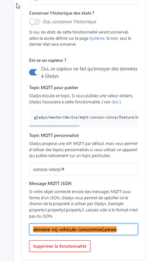

And conversely, in the following example I indeed have an existing feature with parameters where the value is empty…
But then, I didn’t fill anything in the custom fields (and for those I’m sure I never filled anything - however others were populated during creation):

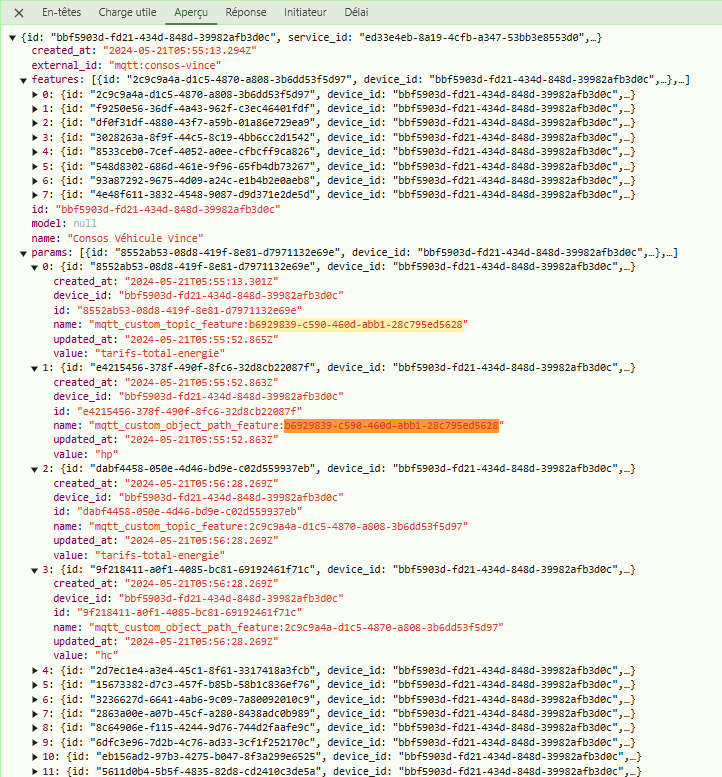

Could there be an issue with params management when deleting features + others?
And indeed I just tested deleting a feature, namely the feature with id b6929839-c590-460d-abb1-28c795ed5628 — it’s no longer in the features but still in the params:
And indeed, after thinking about it, it doesn’t surprise me since params are attached to devices — the link must not exist.
So if we configure a custom topic the same way, I suppose that if we remove it afterwards, it just gets replaced by an empty field.

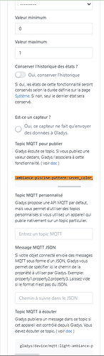

So, test of deleting the affected devices then creating new devices with custom: No more issues :stuck_out_tongue_winking_eye: :
    topic: 'test',
    regex_key: 'test',
    device_feature_id: 'd1a558eb-07d6-4972-900d-c3b4bc1587b8',
    object_path: null
device.params [
    device_id: '6cb64637-71b2-4b34-be5c-75a0eeaff17c',
    value: 'test',
    created_at: 2025-01-17T10:09:39.371Z,
    updated_at: 2025-01-17T10:14:24.625Z
2025-01-17T11:14:43+0100 <error> listenToCustomMqttTopicIfNeeded.js:35 () Subscribing to MQTT topic test
If we then clear the custom topic, we can clearly see that the problem therefore comes from the deletion or the clearing:
