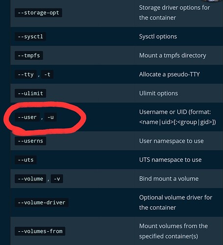

Hello, I put the link to the command’s documentation in my message, here is an excerpt :
@Einstein8854 was talking about it above :
That’s normal, it’s already more technical, it’s the complete opposite of what @pierre-gilles wants.
If you get your hands dirty without understanding what you’re doing, it’s not simple.
