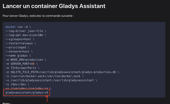

I rather think we should maybe take the problem the other way around — the only « issue » here is that the command I highlighted to launch Node-RED was « latest », whereas I could have highlighted the tagged major version, which would have avoided any problem here.
In the same way that the command to launch Gladys that I provide on the site is locked to the major version « v4 », the day we move to v5 with breaking changes, users on v4 will not be impacted:
