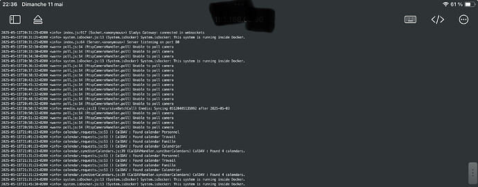

You told me you had gone into Gladys’ logs, normally under the log « Unable to poll » you have a more complete log :slight_smile:
In the long file there is only this line
Indeed!
And if you click on « Test » in the Camera integration, you should normally see the error message in the interface!
