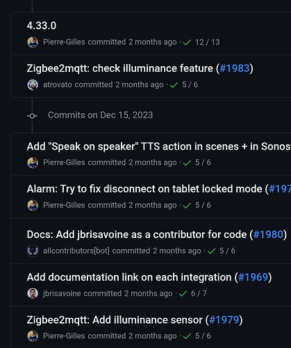

Yes, there was an addition of an illuminance two months ago in version 4.33.
It’s probably related to your problem
Yes, we
[quote=« _Will_71, post:27, topic:8724 »]
There is surely a link to
Indeed ^^ My bad !! And your Gladys output confirms it since you do have one feature with the unit and the other without:
