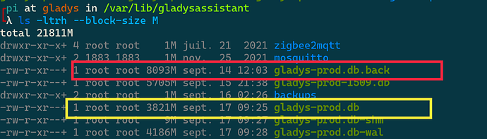

Results in image: a size reduced by 50% :tada:
Now my DB is 3.8 GB instead of over 8 GB!

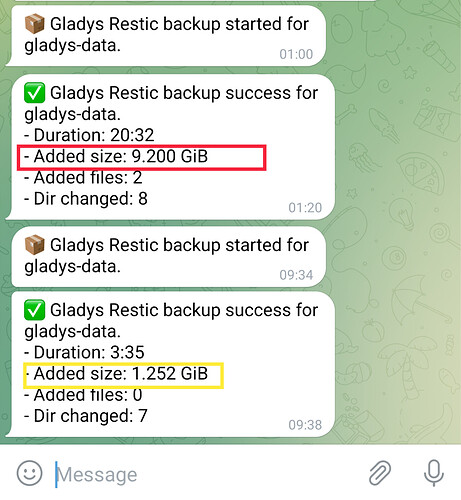

On the backup side (personal), it’s noticeable:

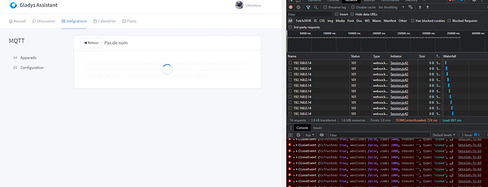

However, now I have a problem: every time I modify a device, for example its name, it locks Gladys for several minutes (easily 10 to 15 min).:sad_but_relieved_face:
Is this normal?
I can provide more details and run tests, but in the evening if needed.

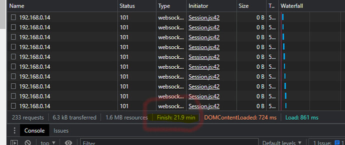

So I tried to add a feature to an MQTT device.
I had to wait about 22 minutes for the page to appear after saving
I confirm I have the same bug.
When I modify my MQTT devices each time, it takes a very long time before it indicates that an error has occurred.
I have to restart the Gladys instance for it to work again, but the change is applied.
