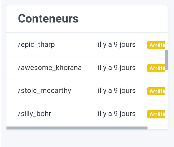

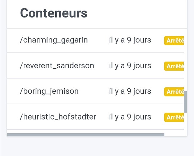

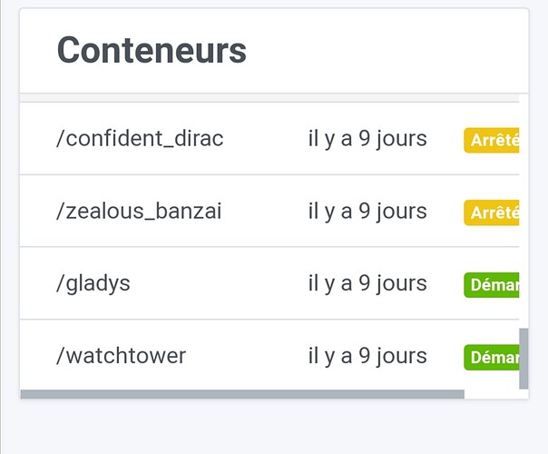

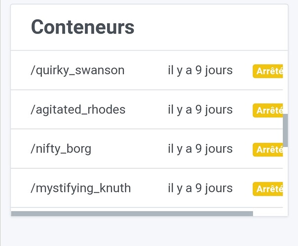

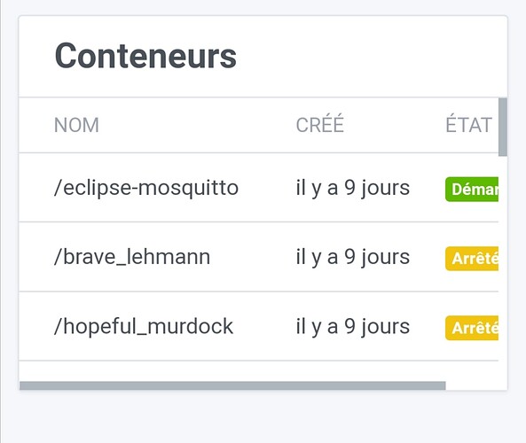

But in the list of containers via Gladys:
Any idea what could have happened?
Nine days ago, I did a full reinstall from the official image…
Should I be worried?

No, those are random names (I don’t really know exactly what you did but on each run you started a container), it’s Docker that does that when you don’t specify a name when creating a container.
docker ps only returns running containers.
‹ docker ps -a › to see more clearly
I don’t know either how I did it, but you’re right, they’re all there!
