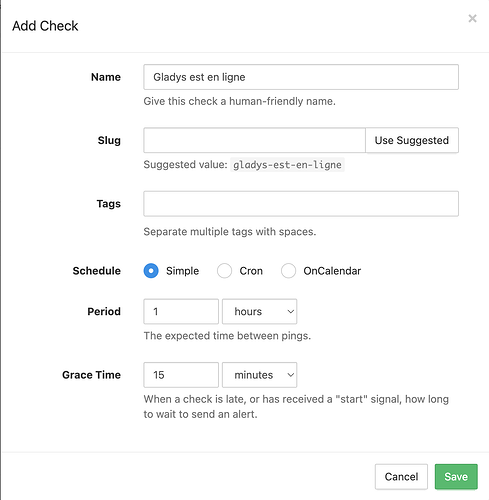

I thought of something, you can use https://healthchecks.io/ to set up a healthcheck for your Gladys.
This will let you know if Gladys itself stays connected to the internet / stays « alive ».
Concretely, you need to create a scene in Gladys that will regularly ping this service, and if Gladys stops pinging the service, you’ll receive an alert (by email by default, but other services are also available)
  1. You create a « Check » (it’s free up to 20 checks)
You can customize if you want to set a shorter period, like every minute if you really want to be precise, or every 5 minutes for example.
In your case, starting with every minute / 2 minutes is maybe best to better track the status of your network/instance.
  1. You copy-paste the URL:

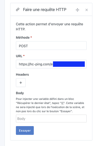

  1. You create a scene in Gladys that at the defined interval (every minute for example) will ping healthcheck using the « HTTP request » action:
this will allow you to know more precisely when/if Gladys is disconnected from the internet/down.

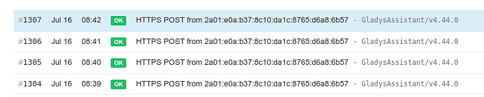

This morning I notice that I’m still disconnected.
On healthcheck.io it still pings correctly.
Unfortunately I can’t access more than 100 lines of history, so I can’t tell whether there was a problem at any point during the night.

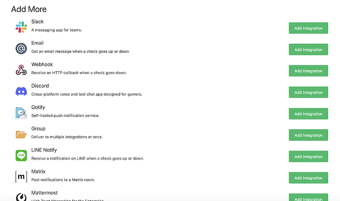

Yes, you get an email if a check is down :slight_smile: (Or any other service if you configured one, like Telegram)
Well, in this case, no email, nothing.
Ok, so no internet outage if it’s still running (or at least, no outage longer than 1 minute)
