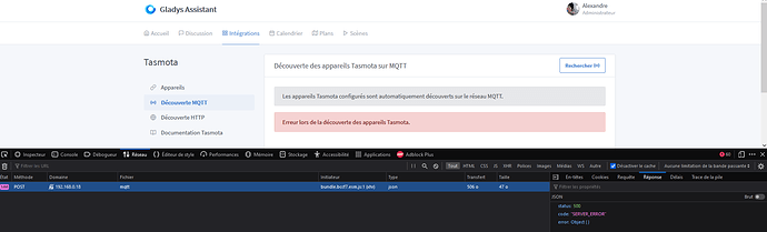

I’m having trouble with the Tasmota integration via MQTT.
I’ve followed all the little guides and various forum solutions, but nothing works, I have 0 devices appearing in the Tasmota section.
I’m using a Sonoff 4CHR3 flashed with Tasmota, the communication up to the Gladys broker seems to be OK.
But when I read the sentence « Tasmota devices configured are automatically discovered on the MQTT network, » it doesn’t appear for me.
The Gladys interface, the Search query goes into error 500:
If you have any ideas, don’t hesitate :slight_smile:
Alexandre
So, I found out, the « Tasmota » service was not started in the services.
