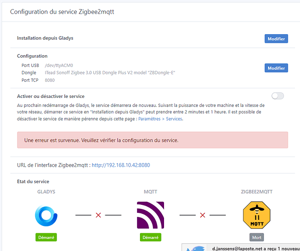

Zigbee2mqtt problem
I can’t find a Zigbee2mqtt disable button → but regarding the service, I’m going in circles:

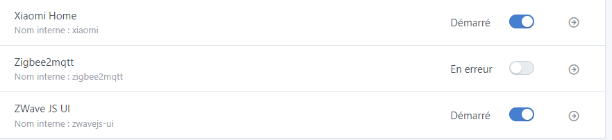

Zigbee2Mqtt is in error
If I click the arrow, I end up on the configuration page. I can reinstall it or modify it, I always get the same message.
The Enable or disable service slider is not accessible.

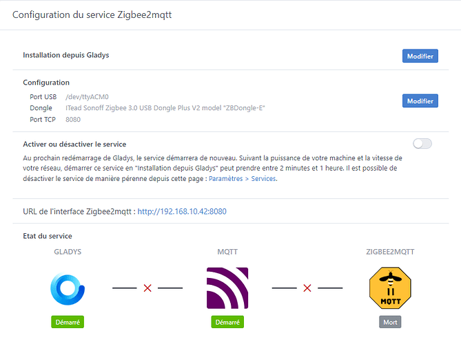

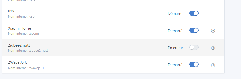

I followed your procedure :
In the service, Zigbee2Mqtt is still showing an error
After reinstalling, nothing has changed

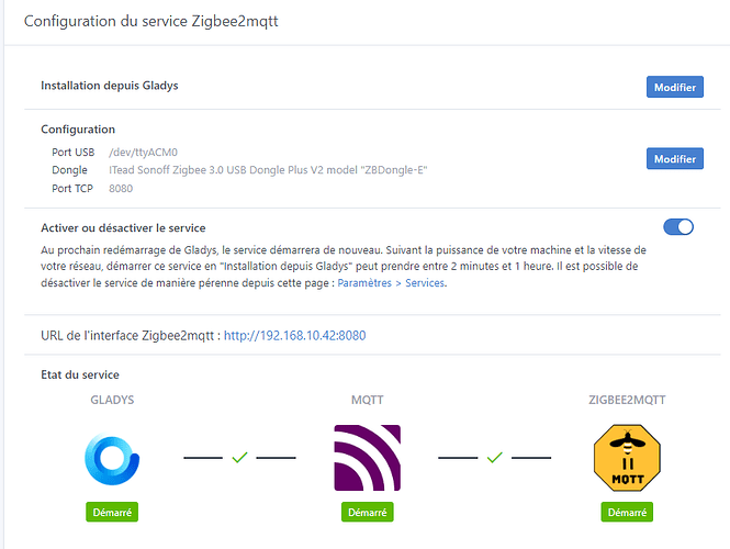

Great, it works
A huge thank you to you and guim31
Daniel
Oh, that’s great! :grin: Keep it up
