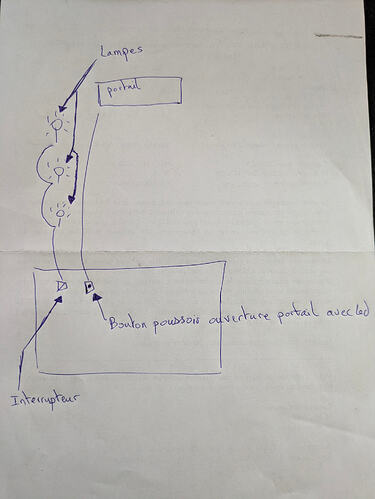

I’d really like to help you with the hardware first, but I’m having trouble visualizing your setup despite your explanations.
Do you have the possibility to draw a small electrical diagram or something to see who controls what?
After that, it’s just a matter of creating scene(s), and that’s simpler.
What I mean is that it’s good to separate hardware and software to see things more clearly sometimes.
Thanks! I’ll do it as soon as possible
Here you go, I hope I’m clear.
To control the lighting, a light sensor is very practical
Thanks for the diagram @thekassmachine
As @pierre-gilles mentioned, a door contactor at the gate level would be great, but we still need to test it with the opening/closing and whether the signal is strong enough, or even a multi-state sensor like the P100 from Aqara.
For the lamp switch, there’s a good chance you don’t have a neutral wire, so a Sonoff ZBMINIL2 would be interesting.
You could also put one behind the push button for the gate opening, which would allow you to send a message to Gladys to open the gate without touching anything.
Then you’ll need to orchestrate all this in one or more scenes in Gladys.

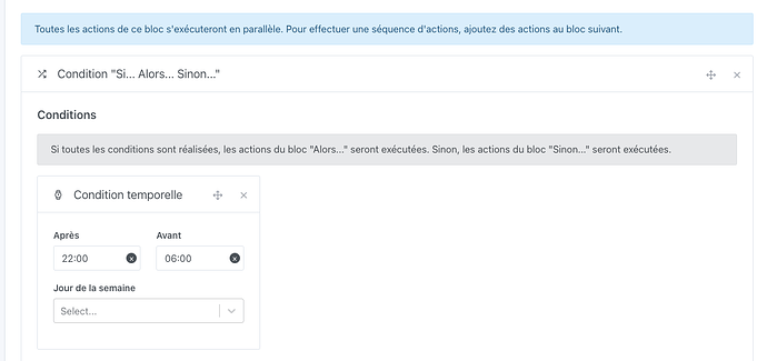

For the schedule, you just need to take an action block with a time condition like this:

The sensor on the gate, I can’t; it’s too far from my installation. That’s why I wanted to retrieve the « open » status of my gate on my button.
For the switch side; I keep the Sonoff module as a favorite :slight_smile:
Unfortunately, as it stands, this is not possible because you have an external remote control (in the car?) to open and a dry contact does not have a status return.
