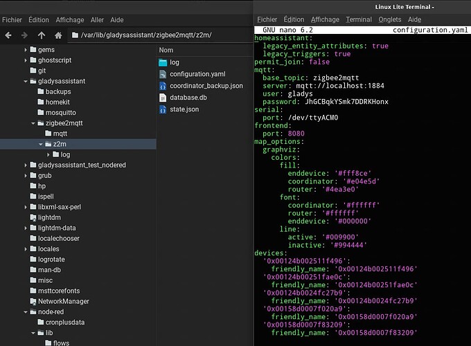

@BooyakaXII I had similar issues with a SONFF P dongle but looking at configuration.yaml I don’t have the line « adapter: ezsp » and yet I do get reports, but only on re-associated devices (I had lost the links but since I rebuilt my machine… not sure that it comes from Gladys or Zigbee)

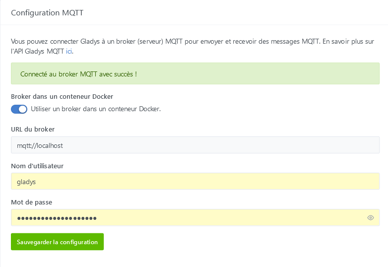

On the other hand, @pierre-gilles is it normal to have a different password (there was a Gladys Plus restore) between
when it is displayed it’s « h9eiA5gE4AH4EOD3RWDI »
and what is stored in the configuration.yaml file
here in the file « JhGCBqkYSmk7DDRKHonx »
In the file the password is encrypted, is that right? Unless that’s what’s causing the problems?

I stopped all the containers, restarted gladys then « save the configuration » but that changes nothing — the two passwords remain different between the display and the file! Bug?
What’s strange is that I edited the file by hand, I stop gladys, I restart it and I end up with the changed file!
I change the password, I save but that doesn’t change anything in the file!
In gladys, I change the password, I save and it’s the old password shown in gladys that comes back when I display it again!!! There’s a bug here!!! :thinking:
Ah but wait @cce66, I got my wires crossed, you’re talking about two totally different things, the MQTT integration != the Zigbee2mqtt integration. What you’re observing is completely normal!
Ah, that puts me at ease!!!
Is it saved, or is that only for the MQTT settings (to check)?
However, it’s not normal that when you change the MQTT password it re-displays the old password as if it hadn’t been saved, is it?
It’s not displayed anywhere, but you don’t need to know all that — if your Zigbee2mqtt installation is working (all the checkmarks are green), then everything is fine!
Normally it should work; I remember you had issues with your browser. I had added a hint to tell your browser not to autocomplete, but maybe your browser doesn’t respect those hints.
