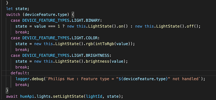

In fact, don’t look any further, I think that on the Philips Hue integration side, the functionality simply doesn’t exist ^^ (not coded)
There is a missing case for temperature change:
See: Gladys/server/services/philips-hue/lib/light/light.setValue.js at master · GladysAssistant/Gladys · GitHub
This case is handled on the Zigbee2mqtt side, but not in Philips Hue.
This is a development to be done… We would need to find someone on the forum who has Philips Hue and would like to help with the development
It would be something like this:
case DEVICE_FEATURE_TYPES.LIGHT.TEMPERATURE:
  state = new this.LightState().temperature(value);
  break;
If I understand the logic correctly?

Indeed something like that, then you need to check the Philips Hue library documentation to see the data format to send and the function name
You need to set up a local development environment.
