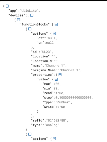

When I then send a topic cloudapp/QBUSMQTTGW/getState
I get the list of my devices:
I imagine I must register each device in Gladys and have a feature “listen to the value that QBUS sends me” (if I use a physical switch) and a feature “send new value to QBUS”.
But how can I tell Gladys that device X must listen to the topic cloudapp/QBUSMQTTGW/UL1/UL41/state which corresponds to the state of my lamp X?

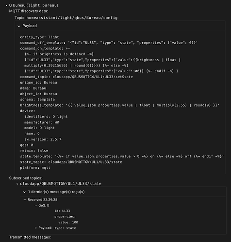

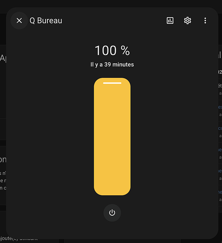

In the preconfigured Home Assistant by the Flemish devs, I do have my lamp with its current state and the possibility to turn it on/off
And here is the config behind that I could find
What is this template thing (example)?
