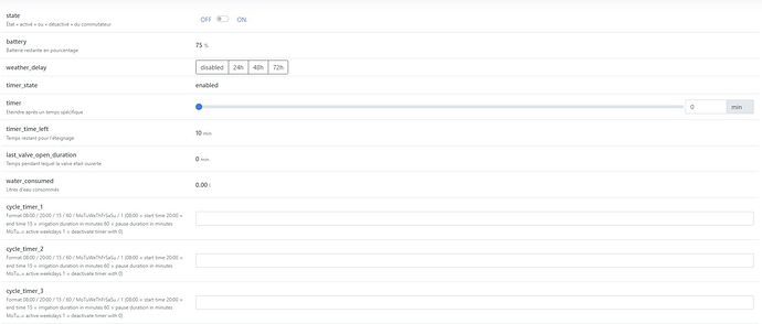

The problem is that the water consumption doesn’t show up in Gladys once the device is added:
Do you have any idea how to resolve this issue?

We don’t have a mapping for consumption yet, I’ll take a look this week to add the sensor.

@Mastho
Can you tell us more about how the valve works?
The timer_state has 3 possible values => disabled, active, enabled. I don’t really see the difference between active and enabled.
In the Z2M interface can you take a screenshot of the expose tab?

When you talk about the ‹ expose › tab, are you referring to this?
VonOx
September 9, 2022, 10:14am
10
Hi, no, I’m talking about zigbee2mqtt itself (port 8080)
The interface has actions; that will make things clearer
