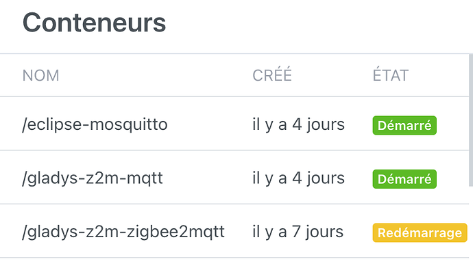

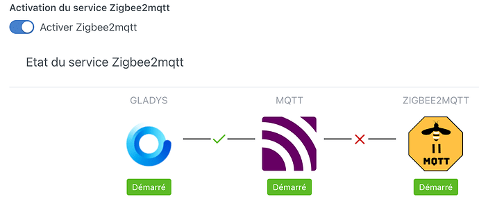

I need help, I have the gladys-z2m-zigbee2mqtt integration that asks me to restart.
I don’t know how to do it.

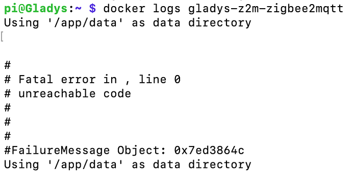

What do the logs say:
docker logs gladys-z2m-zigbee2mqtt
A Sonoff key.
I specify that everything was working very well. I think it’s since the last update 4.8.3.
Here are my logs: I have this in a loop

Hello, one of the latest versions of the zigbee2mqtt library we are using has introduced an issue for Raspberry Pi users.
You can find more information and the explanations to fix the problem here: Docker | Zigbee2MQTT
