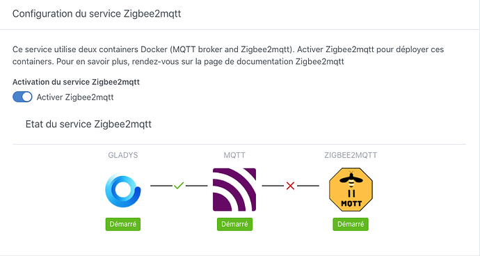

Since updating to version V4.20.0 I’m getting this image when configuring Zigbee2mqtt.
I’ve restarted several times… still the same.
I don’t know what to do.
Help, thank you

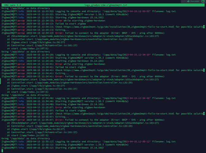

Have you looked at the zigbee2mqtt logs?
docker logs gladys-z2m-zigbee2mqtt
Yes, I ran the command you recommended.
I can see errors but I don’t see why, everything was working fine before the V4.20.0 update.
Thanks in advance for your help.
