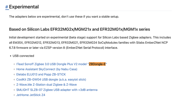

For info, the Sonoff E dongle (not the P) is still listed as « Experimental » on the Zigbee2mqtt side:

When I quickly searched, I came across reviews like this:
Apparently the E dongle isn’t completely stable for now so that would explain all this.. maybe a firmware update for the dongle is needed?
