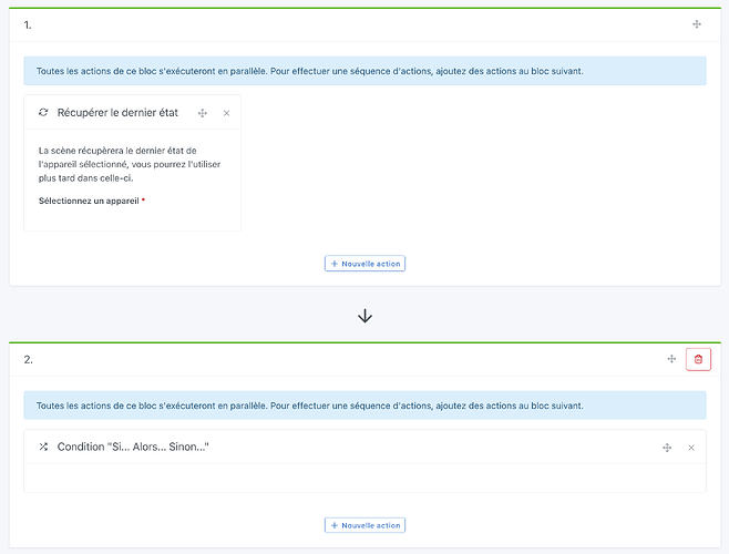

Below are my comments:
The behavior is perfect: if I delete all deletable blocks (with the trash) only one remains, and if I delete all the actions of the penultimate block (the last one never having any action) then that block is automatically removed ![]()
The only thing is that drag&drop of an action block does not work from inside the If Then Else to the outside, or vice versa. But maybe that’s intended to avoid a malfunction…
I reproduce the behavior: a Then (or Else) block cannot become a simple actions block outside an IfThenElse. It can go into another IfThenElse block at the same level (whatever the level, e.g. 22S1 to 23A2 or 22S12A1 to 21A13A1) BUT not into a block of a lower or higher level (23A2 to 22S12A1 or vice versa) and I think that’s why it also can’t go to an external block (so of a higher level).
And another remark: on a collapsed Then or Else, you display “2 actions”. More precisely, wouldn’t it be “2 action blocks”?
I just tested and actually it’s the total number of actions, meaning you can have 2 blocks of 1 action each, and it will show 2 actions in the summary. I think this information is representative of what’s underneath.
And it works the same way when you have a sub-IfThenElse (with actions) inside a Then (or Else) block: if you collapse that Then (level 1), it takes the number of actions from its level AND from the sub-block (level 2). It’s really great!
Note: I can’t move an IfThenElse block to another actions block (from block 2 to block 3 for example).
Note: If I move the block containing an IfThenElse to another block (from 2 to 1), it works.
If I move a block with an action into the IfThenElse block (from 2 to 1), everything breaks and nothing is clickable anymore ![]()

The only thing is that dragging & dropping an action block doesn’t work from inside the If Then Else to the outside, or vice versa. But maybe it’s intentional to avoid a malfunction…
It’s intentional; if I implemented a mixed behavior it would be unusable because it’s impossible to determine which level you want to drag & drop to.
Example: You have a « If… Then… Else » condition that itself contains a « If… Then… » condition; if I drag & drop into a group of actions in the deepest « Then », in practice I’m also inside an action block of the intermediate « Then », and of the root action block. The drag & drop sees that you’re going to drop onto 3 different action blocks…
I think there are solutions, like not making the entire block « droppable » but only a drop zone at the end of the block, but that seems a bit out of scope for this development…
Is this behavior a blocker for you?
If yes, we need to do a specification job on the drag & drop: what do we want? (In that case @StephaneB, it’ll be up to you to take over)
And another remark: on a collapsed Then or Else, you display « 2 actions ». More precisely, wouldn’t it rather be « 2 action blocks »?
They are indeed 2 actions
I count the actions inside the blocks. Counting action blocks is of little interest, I think.
Note: I cannot move a
SiAlorsSinonblock to another action block (from block 2 to block 3 for example).
That’s intentional too; you can’t replace a « classic » action with a « Si Alors Sinon » action and vice versa, for the same reasons you can’t move an action block from a lower level to a higher level.
The same solution is possible, but it’s a proper, separate reflection on the drag & drop behavior; I find it a bit out of scope… Anyway, tell me if this seems blocking for release.
If I move a block with an action to the
SiAlorsSinonblock (from 2 to 1), everything goes haywire and you can’t click anything anymore
Ok I’ll investigate, that’s not normal.
Is this way of working a blocker for you?
Ok for the explanation, it’s clear. And no, I don’t think that’s a blocker.
SiAlorsSinonblock (from 2 to 1), everything goes wrong and nothing can be clicked anymore

@mutmut Do you have more information about this bug? I can’t reproduce it
and here it is:
I just tested on my end and I have an issue with drag & drop.
In the block’s conditions it’s not possible to add as a condition a Condition « If…Then…Else » block, that point is OK
The problem is that with drag & drop you can drag a Condition « If…Then…Else » block into the conditions of another Condition « If…Then…Else » block
For this I created a Condition « If…Then…Else » block in block 1 and another Condition « If…Then…Else » block in block 2.
I then drag & dropped the Condition « If…Then…Else » block from block 2 into the conditions of the Condition « If…Then…Else » block in block 1.
However the block is locked and we can’t do anything with it.
If I then move this block again and pull it out of the conditions it’s no longer possible to put it back.
Drag & drop works the first time but not the second. It should be blocked from the start.

Thanks @_Will_71 and @mutmut for your very thorough feedback, I managed to reproduce it quite easily thanks to your videos ![]()
It’s fixed!
