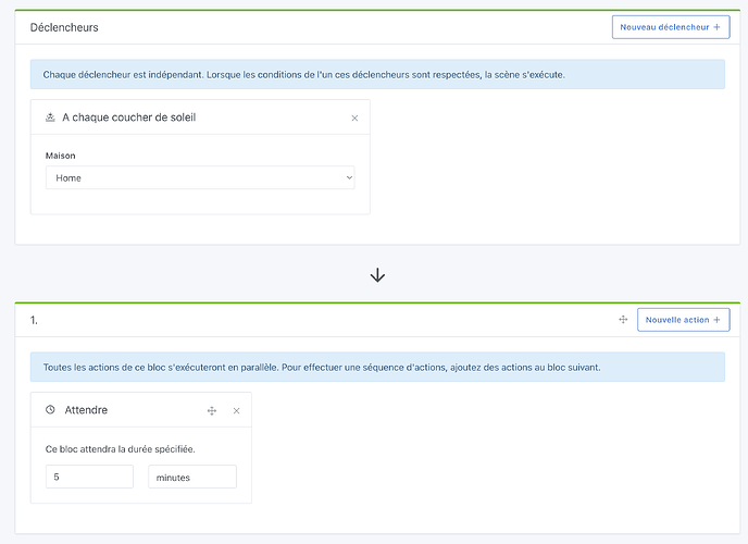

At the moment it’s not possible to wait a random amount of time in Gladys (the « Wait » box does not accept dynamic input)
Either you do a « static » wait (which will still change time each day, since sunset always changes):
Or you go through Node-RED to implement the random wait and create a virtual device « Sunset random wait (Coucher de soleil attente aléatoire) » and a scene that triggers on the virtual device’s state change
