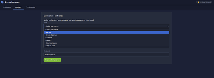

So I created a Scenes Manager: a lightweight Docker container (~25 MB RAM) with a web interface that:
  1. Captures the state of your lights in one click — all protocols, via the Gladys API
  2. Stores presets with adaptive variants (day/night, weather)
  3. Applies the right variant automatically when a Gladys scene calls it

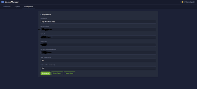

  3. docker run with your presets.json (Gladys API key config + GPS coordinates)
  4. Open http://YOUR_IP:8890

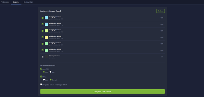

Hi!
What exactly are you talking about, the actual lights? Because for the interface, I added screenshots.
But the idea:
You set all your lights however you want, either from Gladys or from the apps of your connected devices.
And the plugin lets you save the scene in 2 clicks. And for each scene, you can define variants depending on day/night or cloud cover. So for the scene you’ll set these parameters, and you’ll be able to create several presets for the same scene.
Example:
I have a room that’s kind of my geek room where I work and also play because I’m an avid gamer. When I turn on the PC, I call up the scene I made for the room. Depending on whether it’s dark or bright, the colors will be different. And if it’s a rather dark day, they’ll be warmer colors, and on a rather bright day, cooler colors.>
And above all, even without using variants, it’s still super simple to create scenes with multiple lights. Because otherwise, if you do it directly in Gladys’s scene editor, you’ll quickly end up with lots of blocks, since you need one to turn on, one for color and one for brightness for each light.
I don’t know if that’s clearer?
Yes, what it looks like in real life or how you make your choices. Actually, I absolutely don’t have an eye for graphics/aesthetics and I’m curious to know which colors you use at which moments. For example, on a rainy day, which color do you use?
To be honest, I don’t know yet, I’m waiting for it to get dark :rofl:
I had made a similar system on Home Assistant but it had stopped working a long time ago. And I take a lot of inspiration from Philips Hue scenes. I copy the colors for the other devices.
Scenes Manager v2.0 — Simplification : 3 modes instead of variants
Following usability tests, I simplified the variants system which was too complex in practice.
What changes
The old system combined 2 independent axes (day/night x clear/overcast), which resulted in up to 4 variants to capture per scene + a default. In reality, at night we don’t care about the weather — it’s dark outside in any case.
v2 replaces all that with 3 modes:
Mode Quand Logique
Night After sunset Weather ignored
Day — good weather Daytime + clouds < threshold Plenty of natural light
Day — bad weather Daytime + clouds > threshold Little natural light
And above all: no need to fill in all 3. If you only capture one mode, it applies all the time (implicit default). Add the others whenever you want, at your own pace.
New UI
The interface has been reworked to better match the Gladys style:
  • Centered content (less full width)
  • Better contrast between the background and the cards
  • Simple mode selector (3 buttons) instead of day/night + weather checkboxes
  • Badges on the cards to see at a glance which modes are filled
