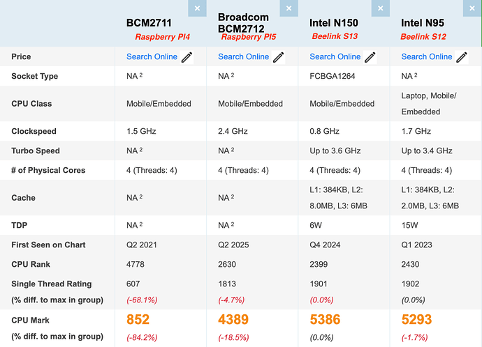

Yes I saw, but Voxtral seems to work from a good small config. My supertonic tests on Raspberry PI 4 8GB allowed me to generate audio clips of about ten seconds in ~8 seconds. Here are a few examples generated in Nodejs on RPI 4 (the links are valid for 7 days, I could re-upload them if necessary) :
Other voices are available including male voices
If it runs on PI4 it will run on better machines (with even better results, by increasing the total_steps parameter for example). The RPI 4 CPU is from 2021 (see benchmark below) with newer devices (such as the Beelink offered via the Gladys all-in-one kit) the latency time will certainly be lower.
Note that in what I imagine, the goal of Gradium and later local models is to have alternatives for the audio notification block in scenes only (not the voice assistant widget of the dashboard which requires an LLM and therefore Gladys Plus), so having a few seconds of delay doesn’t seem very serious.
And once a first local model is implemented, nothing prevents adding others that are larger for more powerful machines.
