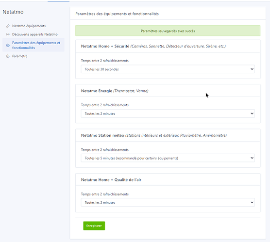

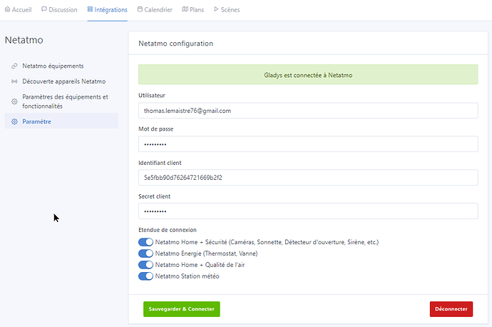

FYI, I just pushed an update (v4.8.4) that incorporates your comment:

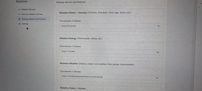

You now have access on the « Paramètres » page to select the APIs you want:
As you only have heating and the thermostat as far as I understand, you will only need to select « Netatmo Energy ».
So if that can reassure you there’s no risk on that side with Gladys because by default we set the requests to every 2 minutes for the Energy part. That represents 2 requests every 2 minutes. Also on the Settings page for devices and features, you can increase the time between refreshes:
For my part, I use the 4 APIs via 2 instances (prod and dev at the same time) with:
  • API Home + Security every 30s = 2 requests/min * 2 instances = 4 requests/min,
  • API Energy every 2min in dev and every 1min in prod = 22 requests/2min + 22 requests/min = 6 requests/min,
  • API Weather every 5min = 1 request/5min * 2 instances = 0.4 request/min,
  • API Aircare every 2min = 1 request/2min * 2 instances = 1 request/min,
  • Total = 11.4 requests/min

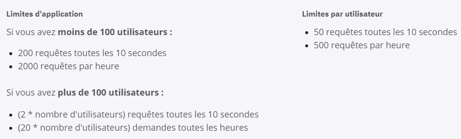

    The limit is 50 requests every 10s, that’s generous ^^

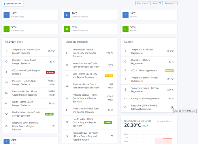

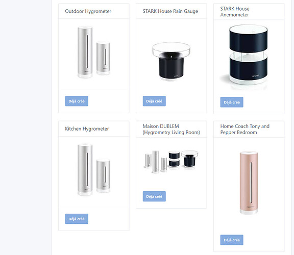

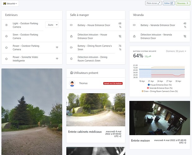

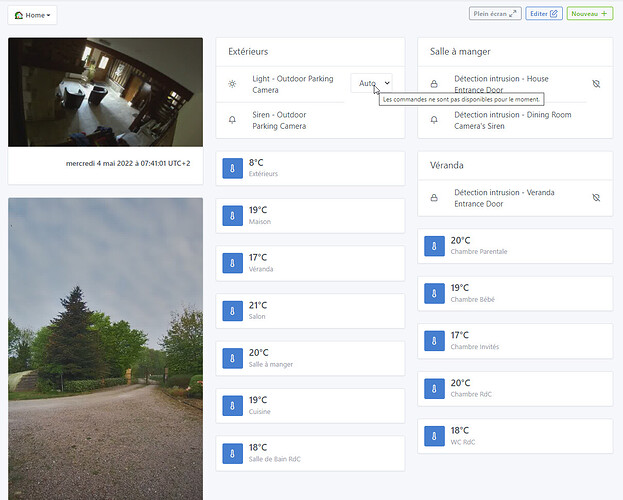

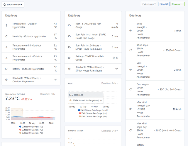

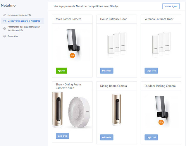

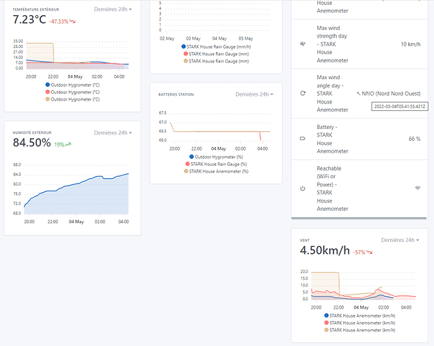

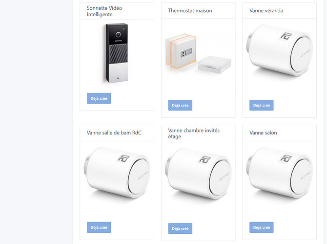

Device Discovery Views :

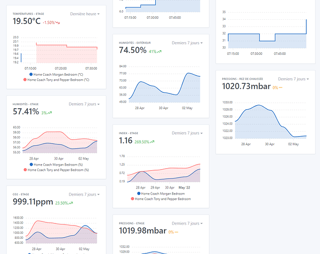

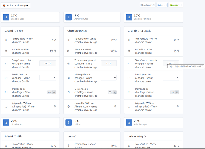

Some views of the Dashboard (Still things to see with the sirens, the commands and the latest update info ^^)
