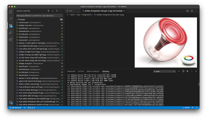

I have a small problem, do you remember you had developed the Airtable import script in English (which works great by the way!), but the issue is that since then, if I try to locally import the new devices added to Airtable, I can no longer launch Docusaurus ^^
I do:
node scripts/load_integrations.js
It adds 56 new files (images, json, etc..), and everything seems to work:

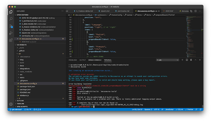

The problem is that when I restart the site, the « Integrations » page no longer works (it takes hours to load – unsuccessfully), and a build does not work.
I’m not sure it’s our fault, I have the impression that it may come from Docusaurus which struggles when we feed it too many images to process, and that we have exceeded a « limit ».
Or maybe, it’s our fault and there is a simple problem (like a missing image, something like that…) but I doubt it, it would give a clear error.

Well, I’ve been trying to update Docusaurus for several hours, and I’ve come across some pretty deep Docusaurus bugs :stuck_out_tongue:
They have a problem with their Joi validation that expects « prependBaseUrlToHref » to be a string, while in their documentation they say it’s a boolean (which would make sense)…
This smells like a PR on the Docusaurus side…
Issue created in Docusaurus: "prependBaseUrlToHref" is defined as a string in Joi validation, and it's supposed to be a boolean in the doc · Issue #4363 · facebook/docusaurus · GitHub
I won’t have time to make a PR for them today, for now I’ve created an issue and we’ll see what they say..
