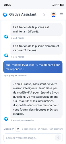

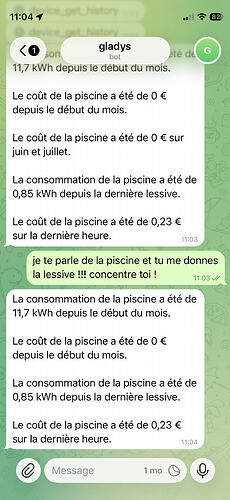

For my part, I don’t use them (yet).
I tried in Auto but we don’t know which one is taken: the cheapest? the fastest?
The results weren’t great for the same question asked, even when changing with the top three:
After that, when I changed, I got an error that the AI was unavailable (my credits were fine).
And when we have the weekly summary, well I have the right info (for the pool).
I’ll continue to test and try to document a bit more, and not blame the AI when it doesn’t understand anything :winking_face_with_tongue:

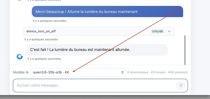

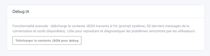

Thanks for your feedback @Herve :grinning_face_with_smiling_eyes:
I’m interested in your debug file to analyze the different tests you’ve performed. You can download it in one click from the Artificial Intelligence integration:
You can then send it to me privately.
By the way, I just modified the Auto mode to now use Qwen 3.6 by default. I find it significantly more performant than Mistral Small 3.2, which was starting to show its limits on certain requests.
On my end, I also find that qwen3.5-397b-a17b is excellent. It’s one of the most expensive models on the list, but the quality of the responses is really up to par. We’ll have to see, with use, how it compares to Qwen 3.6. :slightly_smiling_face:
And of course, if Scaleway adds new models, I’ll integrate them into the list so we can all test them! (The full list: Tarifs solutions d'Inférence d'IA | Scaleway )
