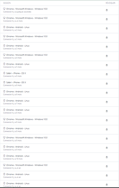

So I tried to revoke all sessions via Settings/Sessions (a menu I never went to) and there I discover traces of many connections including a lot of ‹ unknown ›. So I start clicking on the trash to revoke, I end up with only one connection (Firefox-Linux-Linux64) which seems to be the one open on the new mini PC, I think perfect… but upon refreshing the page, many others appear:
I realize the display is limited and you have to refresh to make the others appear. So I click that trash around a hundred times :hot_face: :hot_face: and from time to time it’s impossible to revoke the sessions. After a while I end up with this list of 20 that I cannot revoke. I therefore suppose there are others but that the display limit is 20 …

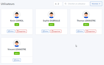

The accounts registered for local are the following:
Why didn’t ‹ Kévin › appear in the choice list of the 3rd step? If it’s this users list that’s being taken into account? It also doesn’t seem linked to the login email since you have to log in with my email address and my password, right?

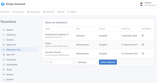

My list of remote users via the local account is:
via Gladys Plus access:
So I would have thought that this list prevails?
By the way how is the link made with the local account? By the email address? But I don’t have a Vincent here, how can I end up on his local account? And if that user also has a Gladys Plus account for his home? How does that work?

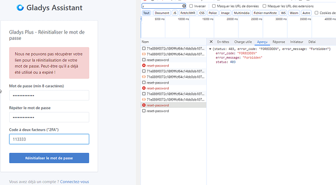

I tried to connect with another account that I had registered a long time ago (Emplacement Camping n°1) and for which I no longer had the password, and when resetting the password, it logically asks me for a 2FA code … But I don’t have one for this account? I tried with mine, but it doesn’t work:

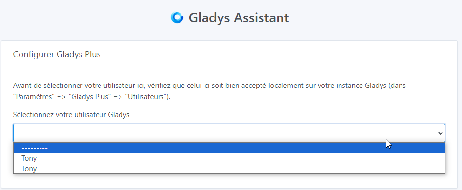

So I run tests again with my 2nd Gladys Plus account which I also use for tests. The 3rd step I was talking about is this one:

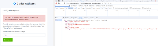

I can clearly see my 2 local accounts (this is my test account for the Netatmo EN and FR dev hence the 2 ‹ Tony ›) and I have the same error as before on either account:
By refreshing the page and confirming with the 1st account it works. If I log out and then log back in, I no longer go through the 3rd step and am directly reconnected to the previous one.

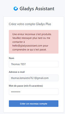

If I invite that same account which already has a Gladys Plus instance, the invitation link sends me to:
There you go… @pierre-gilles, if you have any idea how to get me out of this and how to improve the system… It would help me a lot because I no longer have access to my instance.

  • The list of sessions displayed is the list of all logins that occurred locally. The unknown ones are probably because you make thousands of logins via your Node-RED in API mode, I imagine, and you don’t pass the user-agent so it’s empty… This view wasn’t designed for people who use the login as a workaround to have an API, so indeed it’s not made for someone who has thousands of sessions.
  • For selecting the local user, actually I have no way of knowing which local user corresponds to a Gladys Plus user, so I ask the user to choose (we’re family, in a circle of trust). As for the error you had during the selection, hard to know what happened. Maybe your instance was unavailable.
  • For the login with your terdieu@.. account, I confirm that you did configure two-factor authentication (2FA) when you created your account (I checked), I can reset it if needed :slight_smile:

Yes that’s normal, you’re inviting an email that already has an account. It’s really a far-fetched use case :sweat_smile:
I agree you shouldn’t have been able to invite a user who is already a customer with another account, but well it’s really a unique situation.

Yes so why that error in the first place? After refreshing the page it’s good indeed ^^
Sorry but for this one… « far-fetched »… I don’t understand. We agree the goal is for Gladys to be known and used… It’s enough that two people in the same family, for example, use Gladys Plus and that one helps the other during vacation and we can encounter this issue. Which is my case, my little brother for example. Ok today it’s certainly premature, but why don’t you imagine that one person might need access to two Gladys Plus? In any case I really hope that will be the case.
We agree, to date no requests in that sense ^^ Even if for my part I already need it ^^

In your case, to clean:
DELETE FROM t_session;
But it will come back if you do lots of logins..
