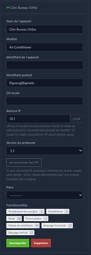

For info @GBoulvin I added support for these issues:
I think and hope that the last one also handles @Papashultz’s pilot wire
And for info, here’s what the Issues look like now:

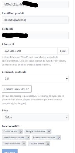

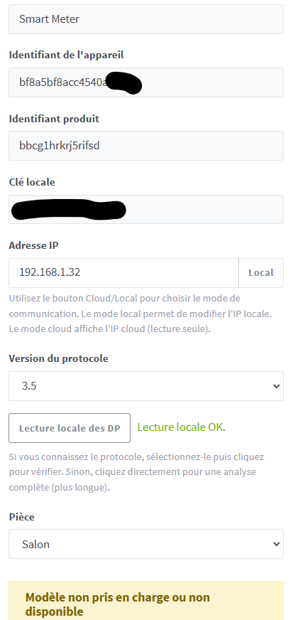

For my part, the “Smart meter” is still shown as “not supported”:
For the LSC sockets, one of the two (protocol 3.5) is functional and listed as supported:

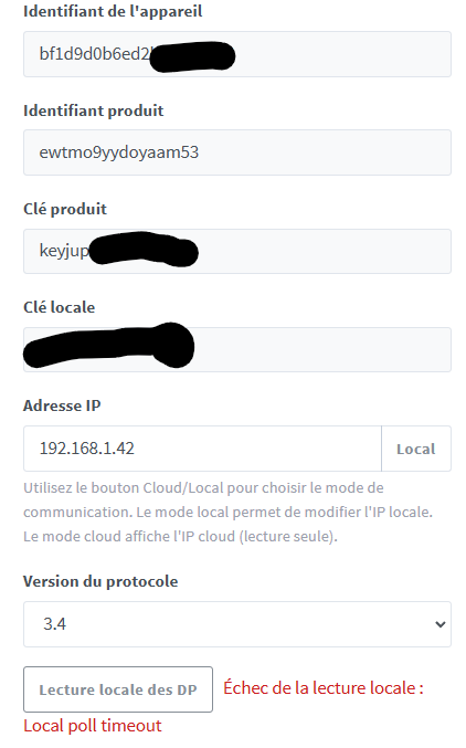

However, the second (protocol 3.4) returns an error for me (both locally and in the cloud).

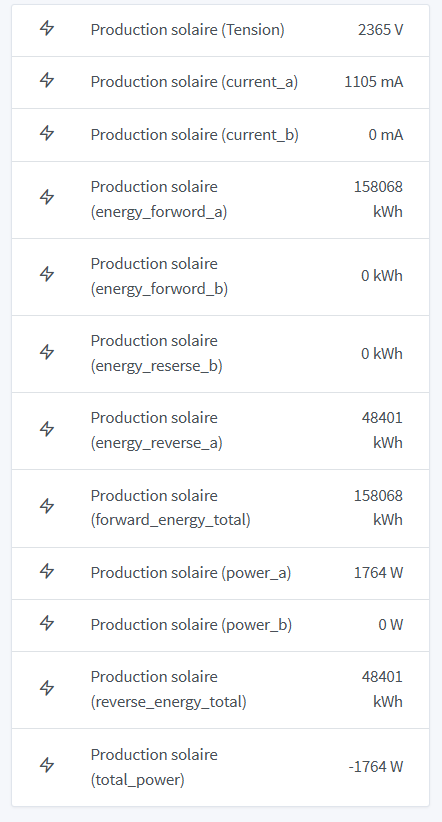

For the Smart Meter, the commas are missing :
But all features appear correctly :

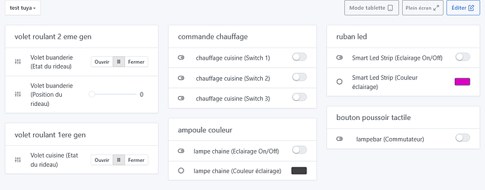

I’m coming in after the fight, but I’ve tested your image. Here’s what I tested for devices:
. All work, there’s only one that doesn’t work completely, it’s the color bulb. You can already see on the dashboard that the colors are dark,
. This is because the lamp is not well recognized, functions such as white mode, color mode, scenario mode are missing, which are in the Tuya app. But the problem was already present before you took over the project. I hope this can help you, thanks for your work. Good evening

Hello!
Protocol 3.5 works fine! However, I can’t get version 3.4 to work. It used to work, I think… The error message is: « Local read failure: Local poll timeout. »
I tested it from a clean image.
Edit: After re-reading previous messages, it seems it wasn’t working after all…
Thanks @GBoulvin for your test.
Indeed, from what I can see (and thanks to the new analysis by Claude Opus 4.7), protocol 3.4 is not implemented. I won’t have enough time to work on it quickly, but I will of course continue the work in this direction.
