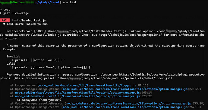

Second problem: when I run npm test on the front end I get this:
How can I resolve this error?
Thanks

These tests are not used, we should remove them, it causes confusion ^^
We use Cypress on the front
Thanks for
