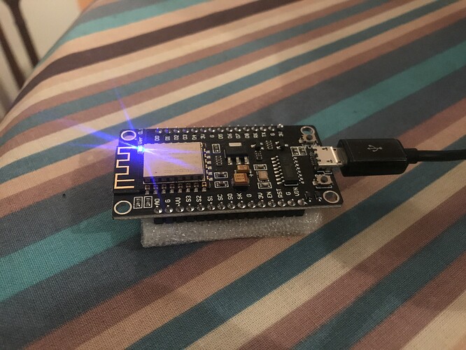

I bought this NodeMCU Lolin V3 Module ESP8266 on Amazon, and I’m rather happy with my purchase :slight_smile:
I connected the device to my computer:

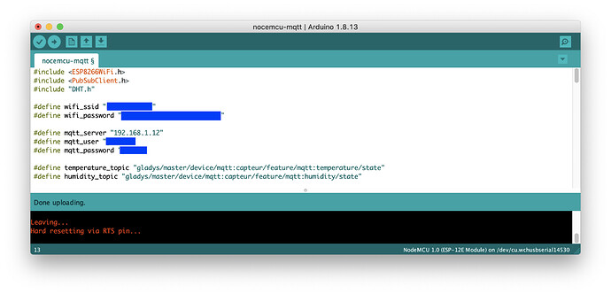

For the programming part, I programmed the board with the Arduino IDE.
I tested the connection to my WiFi network with the ESP8266WiFi library, and everything went well.
Then I connected the DHT11 to Pin D5 + 3V + Ground.

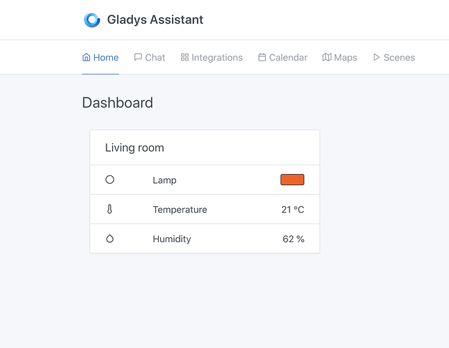

With the DHT.h library, I successfully retrieved the values, which I then pushed to MQTT.
In a few lines, it’s done, I successfully retrieve my values in Gladys:

Could you please publish the code for your project?
