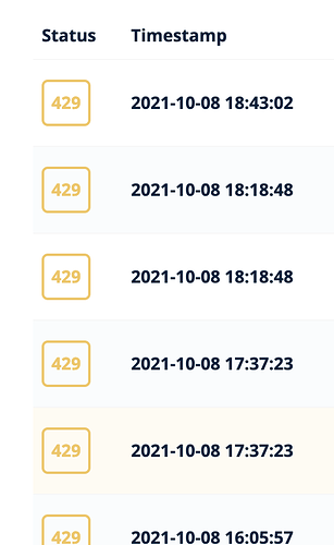

First minor issue (oops), as the CDN contacts the forum with the same IP (it’s a « pull Â» type CDN, so the cache needs to « warm up Â»), the forum’s internal rate limit (Nginx) sometimes blocks the CDN with 429 Too Many Requests.
For now, it hasn’t happened too much, but I’ve seen a few go through:
I’m restarting the forum with the fix!

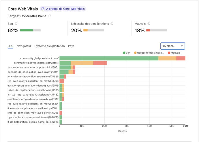

Here’s what I see on my side in Cloudflare (I use their tool to measure web vitals for end users):
As you can see, in 18% of cases it’s bad! This mainly affects mobile browsers when things don’t go well (people browsing the forum on their phones in the subway, for example).
So, we need to improve these numbers for these users!

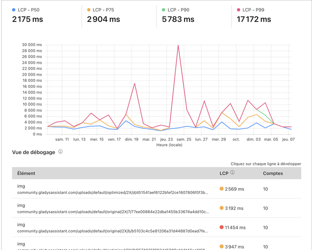

Cloudflare also provides me with a list of file calls that are sometimes slow, and unsurprisingly: it’s images :slight_smile: The CDN will do all its work here for these files.
Now, there’s one thing I haven’t done yet. I need to « regenerate Â» all the forum posts to replace the image URLs in the posts with the CDN URL (I didn’t realize I had to do this myself :p).

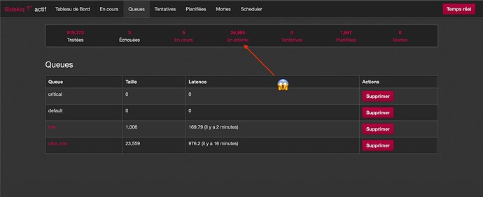

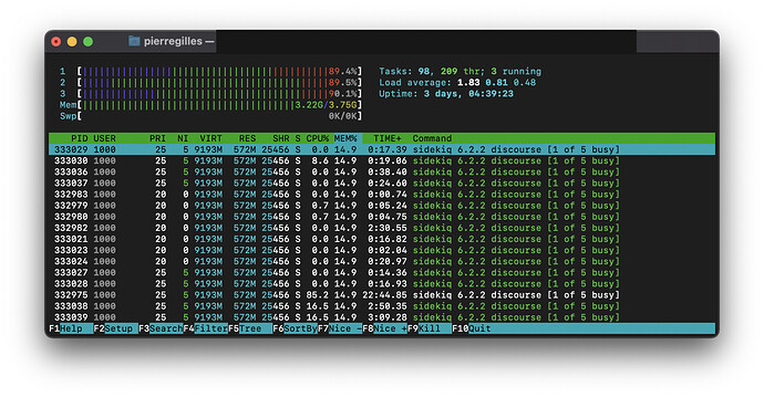

It’s working!!
haha it’s not me who works!! :stuck_out_tongue:
25% of the re-generation!
Screenshot 2021-10-09 at 15.06.58
Good, but it actually creates a task per post on the forum in Sidekiq (the background task manager used by Discourse). Given that there are 49k posts on the forum, we will now need to process the queue :joy:
It will take some time, but that’s just how it is :slight_smile: (and the queue is in « ultra low priority Â» so it doesn’t block normal forum execution)
