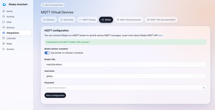

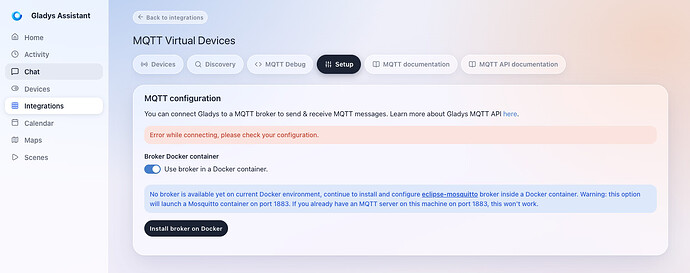

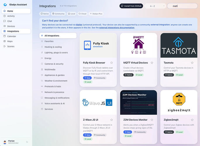

Then: MQTT Broker in One Click
  1. Go to Integrations, type « mqtt » in the search and open MQTT Virtual Devices.
  1. In the Setup tab, enable the toggle « Use broker in a Docker container ». A blue box warns you that a Mosquitto broker will be launched on port 1883: click on « Install broker on Docker ».
  1. Once installed, the screen displays « Connected to the MQTT broker with success! » and the configuration:
    • Broker URL: mqtt://localhost
    • Username: gladys
    • a generated password (eye icon to display it) → copy it, we will need it in step 3.
The broker listens on port 1883 of your Gladys server’s IP, accessible from the entire local network. Note this IP (example: 192.168.1.117).

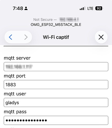

Step 3 — Configure the WiFi and MQTT of the ESP32 (5 min)
On the first startup, the ESP32 does not yet know your network: it creates its own WiFi access point.
  1. On your phone or computer, connect to the WiFi network created by the ESP32 (name of the type OpenMQTTGateway).
  2. A configuration portal opens (otherwise, open 192.168.4.1 in the browser).
  3. Fill in:
Portal Field Value
WiFi SSID / password your WiFi network
mqtt server the IP of your Gladys server (ex: 192.168.1.17)
mqtt port 1883
mqtt user gladys
mqtt pass the password copied from the MQTT screen of Gladys in step 1
mqtt base topic home/ (:warning: leave the default value!)
  1. Validate. The ESP32 restarts and connects to your WiFi then to Gladys’ broker.

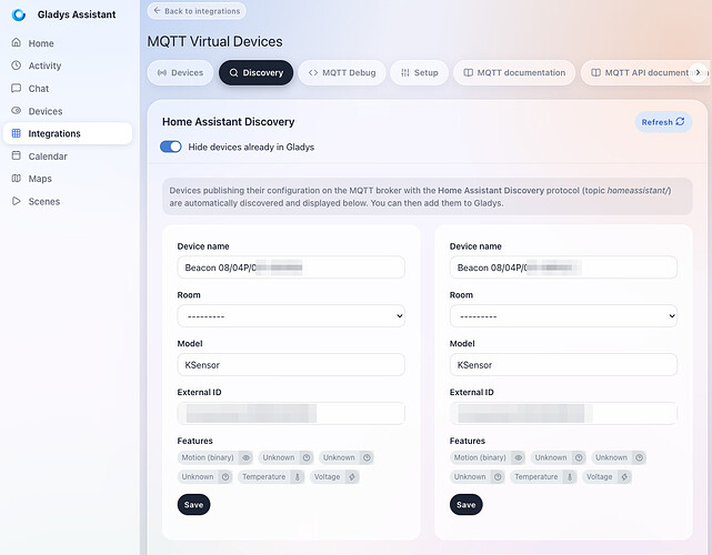

Step 4 — Create Discovered Devices in Gladys (2 min)
Go back to Gladys: Integrations → MQTT Virtual Devices → Discovery tab.
Magic: your sensors are there, with their name, model, and features (temperature, humidity, battery…) already detected.

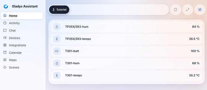

  1. Click on each device to create it in Gladys.
  2. Assign it a room (Bedroom, Bathroom, Basement…).
  3. Add the features to your dashboards: one card per room with temperature + humidity is very readable.
A few real examples of what comes up automatically at my place:
  • ThermoPro TP357/TP358: temperature, humidity, low battery alert
  • Oria T301 (LYWSD03MMC family clone, unencrypted factory firmware): temperature, humidity, battery
  • BlueCharm Beacons: temperature, accelerometer, battery voltage
  • SwitchBot Curtain / Blind Tilt: position, battery, light level (read-only — see the limitations section below)
:hourglass_not_done: Patience on first discovery: BLE sensors only emit every 1 to 10 minutes depending on the model. Let it run for 10 minutes before concluding that it doesn’t work.
