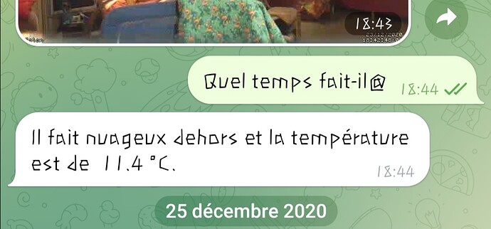

Yes, it worked!
In December 2020 that was supposed to be v4.0.0 :smiley: I’ll test it, maybe that’s it
