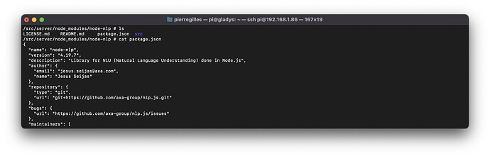

What’s surprising is that this dependency hasn’t been updated recently, so it’s supposed to be the same code as in the last release…
The version in node_modules does match the version in the package.json

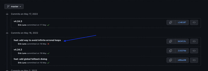

However, in the recent commits of the NLP library’s repo I see something that catches my eye:
Okay, I’m trying to install the previous version on my Pi 3B+ to see if that fixes the issue or not, because in this case nothing has changed in that part (no dependency updates, no code updates)
