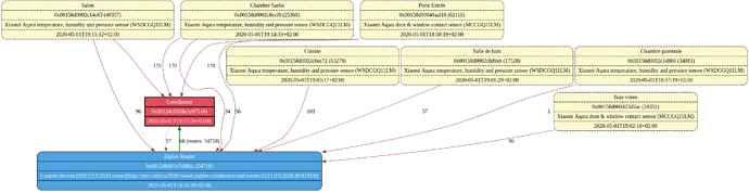

By the way @Reno, do you plan to display the network? (something like for Z-Wave)

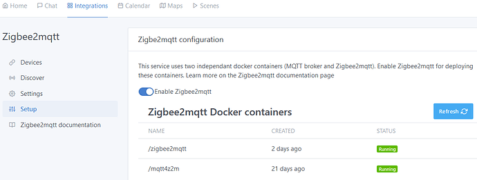

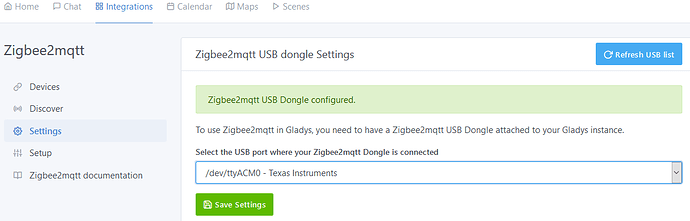

  • A Settings tab that allows you to define on which USB port the Zigbee2mqtt dongle is attached
  • A Setup tab with Enable button of the service that allows to start and stop the external Docker containers necessary for the service. A table allows to display the state of the containers.
  • The service uses its own MQTT configuration independent of the main MQTT service of Gladys.
Today the service can only start and stop the containers, which means that they still need to be created manually at the beginning, following the Zigbee2Mqtt Tutorial. (There is just a small modification to make on the name of the mqtt container which must necessarily be called ‹ mqtt4z2m ›)
The next step in development concerns the automatic creation of containers from Gladys in order to hide the creation steps from the user.
Then, I plan to add a ‹ Pairing › tab to manage the pairing of devices that I find quite laborious with Zigbee and which requires today to look at the logs of the Zigbee2Mqtt container. We could thus have a view of the state of the pairing directly under Gladys.
I think it is feasible to display the network if we can easily retrieve the existing Zwave. On the other hand, I don’t quite see the point of having such a view.

The service launches 2 containers: 1 MQTT broker and zigbee2mqtt.
Both containers have always been associated with the service but had to be managed manually (see my tutorial).
Now it’s transparent for the user and everything is managed from Gladys. The user doesn’t have to go into the broker configuration. It is defined in the code and specific to Zigbee2mqtt.

On a complex network, it’s easier to see who is communicating with whom (Device / Router / Coordinator). The one provided by default is not great, too much information in my opinion. The need is to have the routes, the type of node and the signal quality.
It is in graphviz format:
node[shape=record];
  "0x00124b0018e1e975" [style="bold, filled", fillcolor="#e04e5d", fontcolor="#ffffff", label="{Coordinator|0x00124b0018e1e975 (0)|2020-05-01T19:17:26+02:00}"];
  "0x00124b0018e1e975" -> "0x00124b001b7d88dc" [penwidth=0.5, weight=0, color="#994444", label="17"];
  "0x00158d0002c14c65" [style="rounded, dashed, filled", fillcolor="#fff8ce", fontcolor="#000000", label="{Salon|0x00158d0002c14c65 (40357)|Xiaomi Aqara temperature, humidity and pressure sensor (WSDCGQ11LM)|2020-05-01T19:15:12+02:00}"];
  "0x00158d0002c14c65" -> "0x00124b0018e1e975" [penwidth=1, weight=0, color="#994444", label="170"];
  "0x00158d0002c14c65" -> "0x00124b001b7d88dc" [penwidth=1, weight=0, color="#994444", label="96"];
  "0x00158d0002c8ec72" [style="rounded, dashed, filled", fillcolor="#fff8ce", fontcolor="#000000", label="{Cuisine|0x00158d0002c8ec72 (63279)|Xiaomi Aqara temperature, humidity and pressure sensor (WSDCGQ11LM)|2020-05-01T19:03:17+02:00}"];
  "0x00158d0002c8ec72" -> "0x00124b001b7d88dc" [penwidth=1, weight=0, color="#994444", label="103"];
  "0x00158d00040aaf16" [style="rounded, dashed, filled", fillcolor="#fff8ce", fontcolor="#000000", label="{Porte Entrée|0x00158d00040aaf16 (62116)|Xiaomi Aqara door & window contact sensor (MCCGQ11LM)|2020-05-01T18:50:19+02:00}"];
  "0x00158d00040aaf16" -> "0x00124b0018e1e975" [penwidth=1, weight=0, color="#994444", label="170"];
  "0x00158d00040aaf16" -> "0x00124b001b7d88dc" [penwidth=1, weight=0, color="#994444", label="56"];
  "0x00124b001b7d88dc" [style="rounded, filled", fillcolor="#4ea3e0", fontcolor="#ffffff", label="{Zigbee Router|0x00124b001b7d88dc (54718)|Custom devices (DiY) [CC2530 router](http://ptvo.info/cc2530-based-zigbee-coordinator-and-router-112/) (CC2530.ROUTER)|2020-05-01T19:16:36+02:00}"];
  "0x00124b001b7d88dc" -> "0x00124b0018e1e975" [penwidth=2, weight=1, color="#009900", label="68 (routes: 54718)"];
  "0x00158d0002c8d9ab" [style="rounded, dashed, filled", fillcolor="#fff8ce", fontcolor="#000000", label="{Salle de bain|0x00158d0002c8d9ab (17528)|Xiaomi Aqara temperature, humidity and pressure sensor (WSDCGQ11LM)|2020-05-01T19:01:29+02:00}"];
  "0x00158d0002c8d9ab" -> "0x00124b001b7d88dc" [penwidth=1, weight=0, color="#994444", label="57"];
  "0x00158d0002c14900" [style="rounded, dashed, filled", fillcolor="#fff8ce", fontcolor="#000000", label="{Chambre parentale|0x00158d0002c14900 (34881)|Xiaomi Aqara temperature, humidity and pressure sensor (WSDCGQ11LM)|2020-05-01T18:57:19+02:00}"];
  "0x00158d0002c14900" -> "0x00124b001b7d88dc" [penwidth=1, weight=0, color="#994444", label="1"];
  "0x00158d0002c8ccf0" [style="rounded, dashed, filled", fillcolor="#fff8ce", fontcolor="#000000", label="{Chambre Sasha|0x00158d0002c8ccf0 (25360)|Xiaomi Aqara temperature, humidity and pressure sensor (WSDCGQ11LM)|2020-05-01T19:14:33+02:00}"];
  "0x00158d0002c8ccf0" -> "0x00124b0018e1e975" [penwidth=1, weight=0, color="#994444", label="170"];
  "0x00158d0002c8ccf0" -> "0x00124b001b7d88dc" [penwidth=1, weight=0, color="#994444", label="34"];
  "0x00158d00042345ac" [style="rounded, dashed, filled", fillcolor="#fff8ce", fontcolor="#000000", label="{Baie vitrée|0x00158d00042345ac (24351)|Xiaomi Aqara door & window contact sensor (MCCGQ11LM)|2020-05-01T19:02:18+02:00}"];
  "0x00158d00042345ac" -> "0x00124b001b7d88dc" [penwidth=1, weight=0, color="#994444", label="86"];
In any case, the topology map is not a priority :wink:

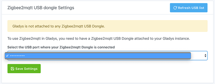

I wanted to test the latest image but I’m having an issue when selecting the USB port of the dongle, no port appears in the list (even after several refreshes)!
However, it did appear in the logs of the zigbee2mqtt_run.sh script execution.
Logs
$ ./zigbee2mqtt_run.sh
Searching for the CC2531 dongle interface
/dev/ttyACM0 - CC2531
Configuring Zigbee2mqtt
Starting the Zigbee2mqtt container
73d2e9b6ebb2b4fb7ef534a7ffcb5dbb91262cfa3a7c02a243a0bb8c5a3ea081
zigbee2mqtt
Any idea where this could be coming from?

Yes, I’ve been struggling with this since this weekend…
For development, I run Gladys directly on RPi, without Docker.
When I added USB management, I reused what was done in the Z-wave service, but since I also have a Z-wave dongle, I realized that the display used did not allow easy distinction between the Z2M dongle and the Z-wave dongle.
In the display, I added the manufacturer info that comes from the USB device in Linux.
When you go under Docker, the container retrieves the ‹ path › of the dongle (/dev/ttyACM0 for example) but loses all other information, which causes the display problem you are encountering.
To avoid this, I added the option -v /run/udev:/run/udev when launching the Gladys container.
You need to make sure you have this option in Gladys_run.sh.
Could you also tell me which distribution you are running? I have only tested with Raspbian Buster.
