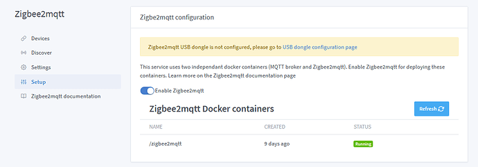

@Reno I just launched the container, are we in agreement that we have to go through your containers? Is there no way to use an existing MQTT server for now?
The log: (I don’t know what it has subscribed to :D)
  vonox  ~  docker logs gladys-zigbee2mqtt
> gladys-server@ start:prod /src/server
> cross-env NODE_ENV=production node index.js
Initialising OpenZWave 1.6.974 binary addon for Node.JS.
        OpenZWave Security API is ENABLED
        ZWave device db    : /etc/openzwave
        User settings path : /src/server/services/zwave/node_modules/openzwave-shared/build/Release/../../
        Option Overrides : --Logging false --ConsoleOutput false --SaveConfiguration true
2020-05-08T12:25:23+0200 <info> index.js:20 (Object.start) Starting Dark Sky service
2020-05-08T12:25:23+0200 <info> index.js:16 (Object.start) Starting zwave service
2020-05-08T12:25:23+0200 <info> index.js:19 (Object.start) Starting telegram service
2020-05-08T12:25:23+0200 <info> index.js:13 (Object.start) Starting usb service
2020-05-08T12:25:23+0200 <info> service.start.js:16 (Service.start) Service darksky is not configured, so it was not started.
2020-05-08T12:25:23+0200 <info> service.start.js:16 (Service.start) Service telegram is not configured, so it was not started.
2020-05-08T12:25:23+0200 <info> service.start.js:16 (Service.start) Service zwave is not configured, so it was not started.
2020-05-08T12:25:23+0200 <info> service.start.js:16 (Service.start) Service zigbee2mqtt is not configured, so it was not started.
2020-05-08T12:25:23+0200 <info> service.start.js:16 (Service.start) Service mqtt is not configured, so it was not started.
2020-05-08T12:25:23+0200 <info> index.js:63 (Server.<anonymous>) Server listening on port 4080
2020-05-08T12:27:06+0200 <info> docker.stopContainer.js:18 (Docker.stopContainer) container zigbee2mqtt stopped
2020-05-08T12:27:07+0200 <info> docker.startContainer.js:18 (Docker.startContainer) container zigbee2mqtt started

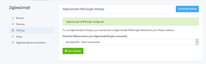

2020-05-08T12:31:55+0200 <info> connect.js:23 (Zigbee2mqttManager.connect) Zigbee2mqtt USB dongle attached to /dev/ttyACM0
2020-05-08T12:31:55+0200 <info> subscribe.js:12 (Zigbee2mqttManager.subscribe) Subscribing to MQTT topic zigbee2mqtt/#
