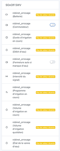

And so first test at my place:
At first glance, apart from the switch, nothing else works for me :frowning:
However, on the source, I do have the info:
Interesting thing but I don’t know why.

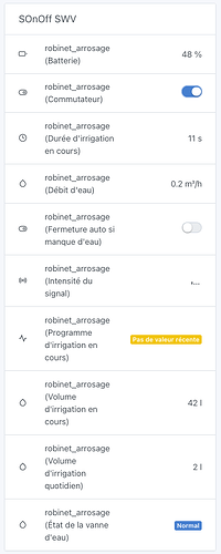

I launched MQTT Explorer to check after the first test and there: nothing in the valve topic (except the on state).
Then I sent an on to my production and all the info appeared in MQTT Explorer :face_with_raised_eyebrow:
Of course I had the info in test Gladys:
I set it to on in test and a few values changed: water flow rate, daily irrigation volume, and current irrigation volume. However, there was no change in the current irrigation duration.
This being written, it also doesn’t change in Z2M (version 2.12.1) whereas it was working before (<2.12.0). Well anyway, we get the correct values back so I’d say okay.
A few remarks if you can:
  • water flow rate: no need for seconds or liters, it’s a volume/time
  • current irrigation program: not sure if it’s relevant as it seems to correspond to what can be set in Z2M. However, if we can retrieve everything, it can avoid creating scenes to set 10 minutes of watering for example.
  • Water valve state: 3 states, I don’t know if you have them. I don’t know when they occur.
It looks great! Plus, we can retrieve all the information. Thanks @Will_71

For the valve status, I saw that it is well detected
Did you add it to your list?
No problem with the units, I’ll look into correcting them.
For the current irrigation program, I’ll see what I can do, but if it allows access in scenes, it could be useful

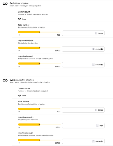

@mutmut, I made some changes if you can retest on the same image.
I created a new display for the setting because with large values, whether the slider or the numerical value, it wasn’t optimal for modifying the values.
Here’s what it looks like (ignore the values as it’s just a test).
Keep me posted!
Thanks for the update!
On the MQTT Explorer side, I do see the reflection when I change a value, but nothing in Z2M or rather an error:
z2m: Publish 'set' 'cyclic_quantitative_irrigation' to 'robinet_arrosage' failed: 'Error: ZCL command 0x44e2f8fffe051863/1 customClusterEwelink.write({"20489":{"value":{"0":10,"1":0,"2":0,"3":0,"4":0,"5":0,"6":83,"7":0,"8":0,"9":0,"10":0},"type":66}}, {"timeout":10000,"disableResponse":false,"disableRecovery":false,"disableDefaultResponse":false,"direction":0,"reservedBits":0,"writeUndiv":false}) failed (Status 'INVALID_VALUE')'
z2m: Publish 'set' 'cyclic_quantitative_irrigation' to 'robinet_arrosage' failed: 'Error: ZCL command 0x44e2f8fffe051863/1 customClusterEwelink.write({"20489":{"value":{"0":10,"1":0,"2":0,"3":0,"4":0,"5":0,"6":226,"7":0,"8":0,"9":0,"10":0},"type":66}}, {"timeout":10000,"disableResponse":false,"disableRecovery":false,"disableDefaultResponse":false,"direction":0,"reservedBits":0,"writeUndiv":false}) failed (Status 'INVALID_VALUE')'
z2m: Publish 'set' 'cyclic_quantitative_irrigation' to 'robinet_arrosage' failed: 'Error: ZCL command 0x44e2f8fffe051863/1 customClusterEwelink.write({"20489":{"value":{"0":10,"1":0,"2":0,"3":0,"4":0,"5":0,"6":0,"7":0,"8":0,"9":0,"10":0},"type":66}}, {"timeout":10000,"disableResponse":false,"disableRecovery":false,"disableDefaultResponse":false,"direction":0,"reservedBits":0,"writeUndiv":false}) failed (Status 'INVALID_VALUE')'
That said, I’ve never managed to change these values directly in Z2M and have them stay fixed (it always goes back to the default « neutral » value).

and when I modify directly in Z2M, I get this:
z2m: Publish 'set' 'cyclic_timed_irrigation' to 'robinet_arrosage' failed: 'Error: ZCL command 0x44e2f8fffe051863/1 customClusterEwelink.write({"20488":{"value":{"0":10,"1":0,"2":10,"3":0,"4":0,"5":0,"6":0,"7":0,"8":0,"9":0,"10":0},"type":66}}, {"timeout":10000,"disableResponse":false,"disableRecovery":false,"disableDefaultResponse":false,"direction":0,"reservedBits":0,"writeUndiv":false}) failed (Status 'INVALID_VALUE')'
So, what actually works? Because if there are issues with MQTT Explorer and Z2M, there will be the same with Gladys. So is it worth adding them?
For me, it’s not worth adding all the cyclic_xxxxx_irrigation.
OK, in that case, I’ll remove Cyclic timed irrigation (composite) and Cyclic quantitative irrigation (composite).

@Will_71 I just tested your latest image, everything is fine with the units and we no longer have the « cyclic blabla » so it’s great. The zigbee2mqtt:robinet_arrosage:water-valve:valve-work-state:valve_work_state feature seems to be linked to the « cyclic » so in my opinion, it’s not necessary either:
